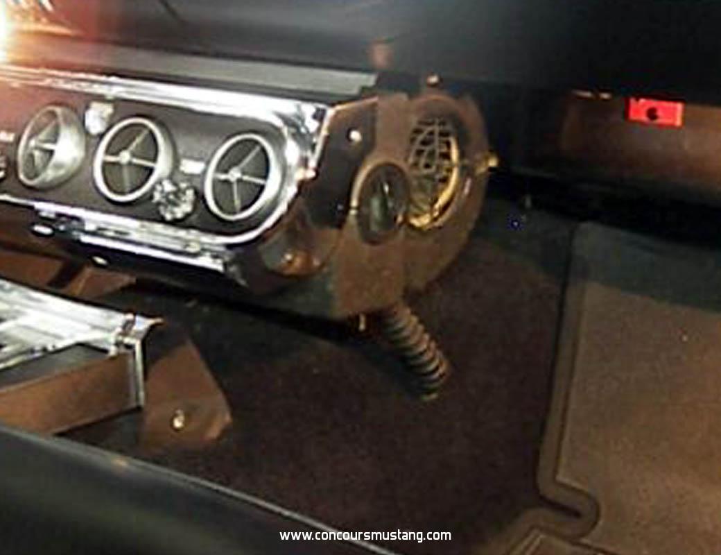

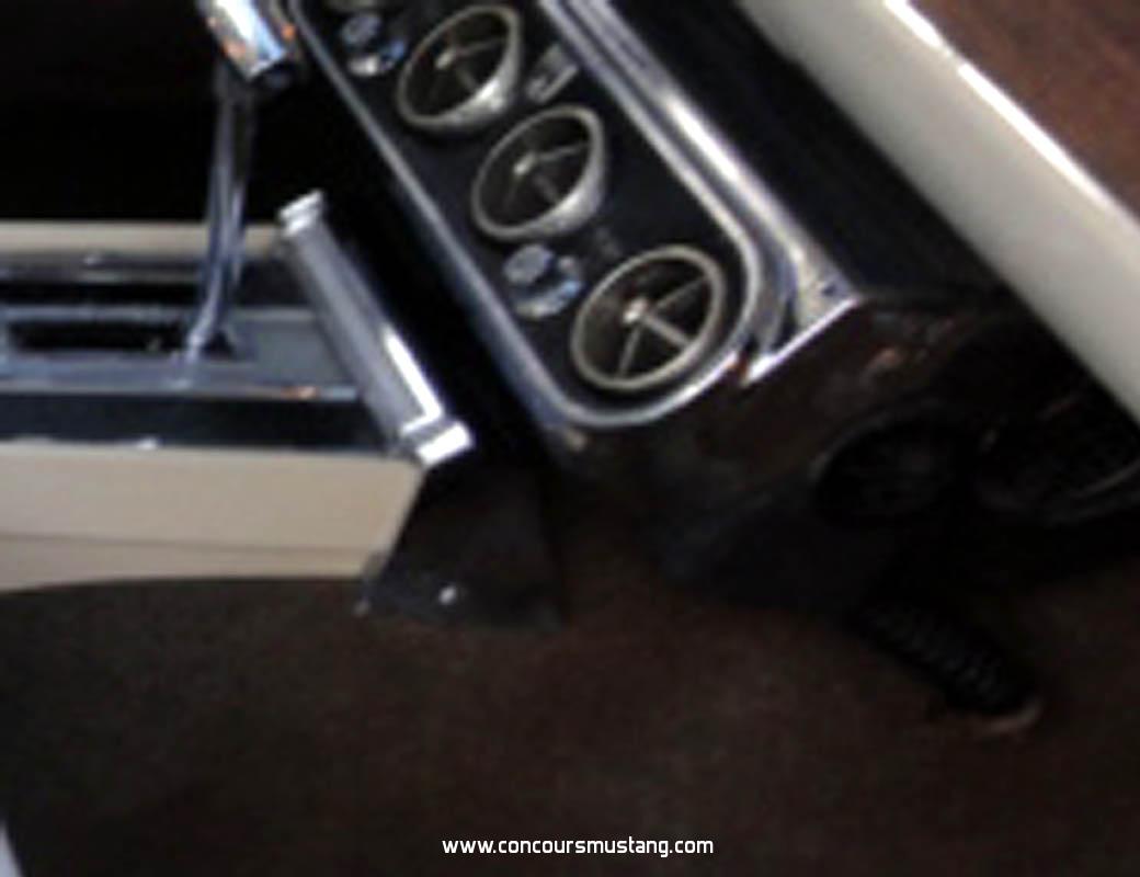

Original poster didn't specify if they were asking about any particular year so thought some might be assuming that the hoses were all the same (since added "65" to the post header)
Here are just a few examples from 66 production ;)

Learned something new today.  I had no idea the AC drip line hose for '66 was so different from the '65.  Very strange that Ford went back to a smooth rubber hose style drip line in '67 and later versions of the AC.  Perhaps the corrugated plastic / rubber tube in '66 wasn't durable?
« Last Edit: January 10, 2015, 06:18:22 PM by rocket289k »
1965 "A" Code 289 Mustang GT - Planned Build Date July 19 / Bucked July 21 Metuchen / Factory AC & PS / C4 Auto / 3.00 open
Offline drummingrocks
  • Posts: 1292
Re: 65 AC Drain Hose
« Reply #14 on: January 10, 2015, 05:57:55 PM »
Learned something new today.  I had no idea the AC drip line hose for '66 was so different from the '65.  Very strange that Ford went back to a rubber hose style drip line in '67 and later versions of the AC.  Perhaps the plastic tube in '66 wasn't durable?
The '66 version is rubber too, not plastic.  At least the repro is.
