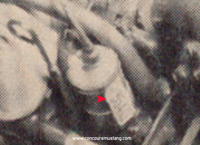

Thanks for the input. I think I have what I need but I need one more clarification. The Engine ID decal that goes on the coil bracket. I have not seen original cars, but it seems that restorations have them installed in two ways:  vertically so that they are attached to the top side of the coil, then bracket, and then the bottom side of the coil, but also horizontally so that the decal is only on the bracket. Which would be more correct for a December 1965 Dearborn build?  Thank you.
Re: Decal Crazy - 66 Dearborn
« Reply #10 on: March 25, 2015, 06:05:22 PM »
........... The Engine ID decal that goes on the coil bracket. I have not seen original cars, but it seems that restorations have them installed in two ways:  vertically so that they are attached to the top side of the coil, then bracket, and then the bottom side of the coil, but also horizontally so that the decal is only on the bracket.
Looking at "restored" cars I would guess :)
For your time period its sort of a toss up IMHO. Detail is not vehicle assembly plant dependent but engine plant related.  The normal/typical/correct way would be horizontal over the bracket and side of the coil for that time period IMHO. Not the best picture but it works. Car was barely months old and the sticker is already coming off
Offline Building 3
  • Posts: 353
« Reply #11 on: March 26, 2015, 05:38:35 PM »
Jeff,
That photo is perfect.  Now I know exactly where it goes and how it should look.
Thanks!
