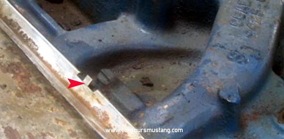

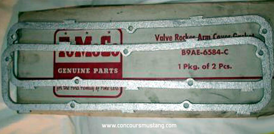

On big block FE engines originally equipped with chrome valve covers its been observed  that originally they (Ford) normally painted the cork gaskets with silver paint then to speed installation they stapled each ear of the gasket to each ear on the valve cover. Staples go around the ear on the valve cover rather than through the metal. Staples are a bit heavier/thicker than a normal paper staple.
Prepainted gaskets
Arrow shows the "ear" I refer to above
