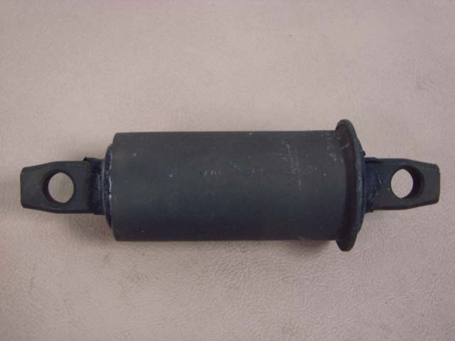

These bushings arrived very quickly since they come from CA.
Although the others may look ok, these are actually FoMoCo numbered bushings. D7s.
I want the Shelby to have as many original assembly line (and original to the car) parts as possible. Since the rubber on even NOS saddles is sometimes not any better than the cracked rubber on 50 year originals, that's a problem.
So now I can have original to my car saddle metal and original Ford bushings! I also like the olive drab color of the shell. Wonder if that's correct?
On to build the sleeves necessary to keep the saddle from collapsing when I press these in and out.
[on edit]
Do note that the Ford Parts D7 Saddle Assemblies look close, but no cigar.
Not only is the lip for containing the spring pigtail different, so is the saddle configuration itself.
First pic has 65-67 saddle on top and D7 on bottom.
Second pic has D7 on left and original 65-67 on right.
I'll leave it to others to discuss for how long these configurations remained this way.
