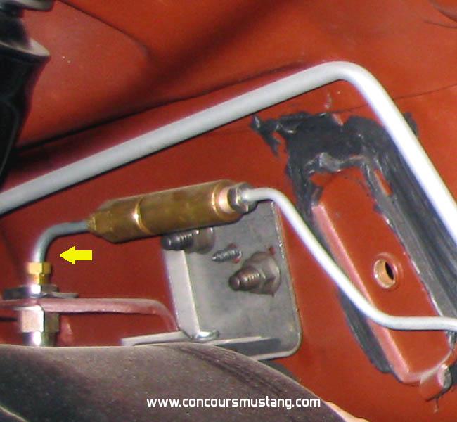

« Reply #5 on: July 12, 2015, 06:21:57 PM »
As mentioned in Reply #2 - does it look like this short section of brake line and fittings?
Re: June 67 - Brake line question
« Reply #6 on: July 12, 2015, 07:05:01 PM »
The reason for the change had to do with the master cylinder fault light used with power disc brakes. The later builds plumbing routed the rear brake fluid thru the fault switch and proportioning valve before it went to the rear axle. This system was continued from 68 on. There are other discussions on this forum about the lines.
« Reply #8 on: July 13, 2015, 05:04:10 PM »
That's awesome guys. I couldn't find a pic anywhere of that.
Is it possible to find that little elbow for sale?
Don't know if its reproduced. Just a thought - release yourself from always thinking first about ordering something out of a catalog. Most/many parts places can make you a fuel or brake line - in this case with the overall length and the fitting size they can make one up.  But for 100% concours the challenge will be to find steel fittings in dichromate. But if you find steel ones finished in zinc you can daub a little clear gold over to try and dupilcate
Just a thought
BTW the one in the picture was a made up one - need to contact the shop and have them switch it out since they made it up with brass fittings :(    But at least it shows the location - basic shape.
