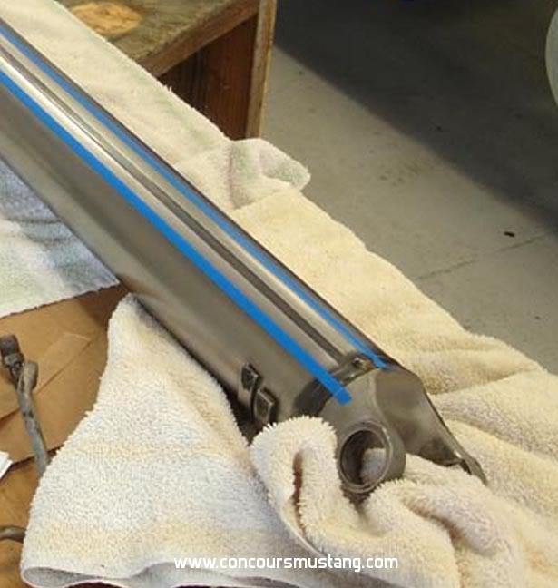

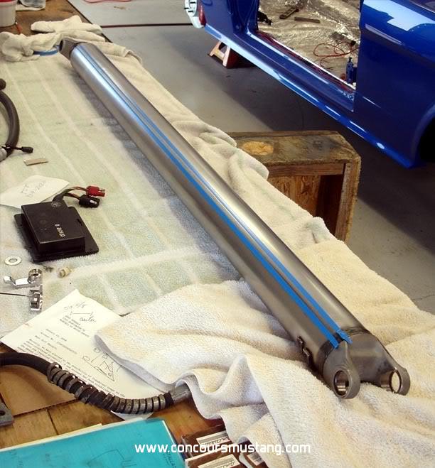

6- Next I found the original seam in the driveline tube. This is where the flat piece of metal was formed into a tube and welded the complete length. Like the ends of the tube this seam would also show a heat line originally. It would have been darker at the center, fading out to nothing at the edges.
To reproduce this I first laid out two lengths of stripping tape approx 3/8” wide and then, with a rag, applied a uniform coat of gun bluing, working it into the rag and tube as a rubbed. I did this twice to insure a dark line.
7- Next I remove the tape and then reapplied two more strips of tape approx  ¼-3/8” from the edge (on each side) of the first stripe.  To this I applied a light coat of gun bluing using a rag one more time, working it into the metal and the rag leaving no liquid on the metal.
8- Finally I removed the last of the tape and lightly sanded the heat stripe and the edges so that all noticeable signs of the tape (sharp edges) were erased and the overall look was muted. Once you get a good consistency (one end to the other) stop!
