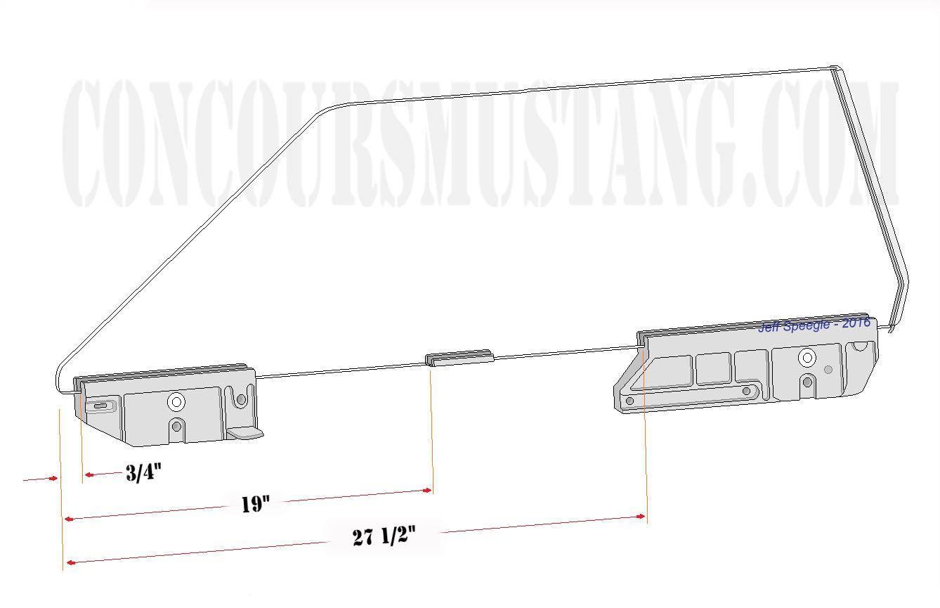

When gluing the brackets to the side glass, what are the correct measurements? There is a reference to 1" from each end of the glass and then there is reference to a 3/4" measurement from the edge of the glass. Which is correct?

3/4"

« Reply #2 on: May 07, 2016, 08:39:45 PM »
