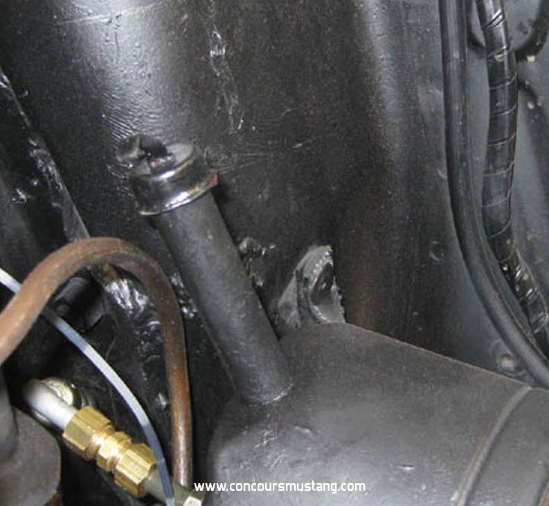

On 7R01C120xxx 7F01C129xxx (correction) I found the power steering hose strap and fastener shown in the first two pictures.   My own 7R02C156 car had a plastic push pin fastener instead, shown in the third picture.   Any other observations out there so we can determine what was used and approximately when?
The 7F01C129xxx bolt is very similar to those used to mount the steering column bracket to the firewall.  I have not compared them in detail yet.  Note the "rose" colored washer, whereas the screw is P&O.  I suppose the rose may be a washed out gold color.
Note that the hex nut in the pictures is simply for color contrast.

John,
All of the original fasteners I have seen were a odd metal push pin that had J hook pins on them I will try to get some pictures. Did the bolt thread the hole or have some kind of a nut?

Mary, the screw threaded directly to the shock tower, no nut.

Thought we had done this subject before. Found one you started for 67 and another for the 68 cars (introducing the possibility that a different style of retainer was used)
67 Thread
http://www.concoursmustang.com/forum/index.php?topic=2753.msg14687#msg14687
Believe what you've found is a replacement/repair from a PO

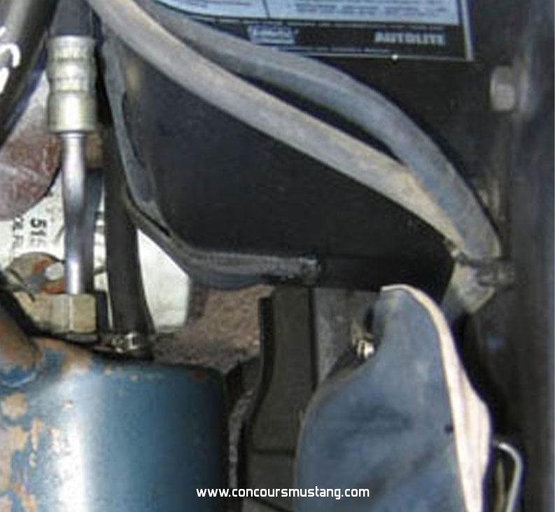

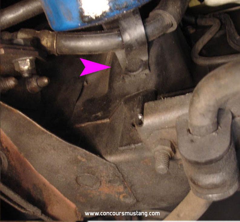

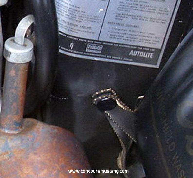

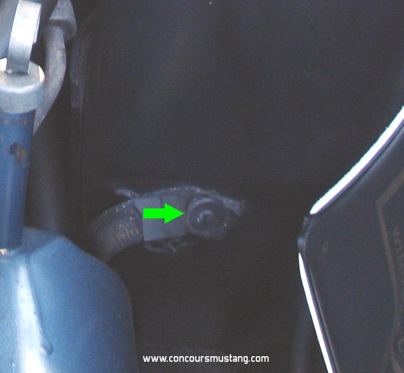

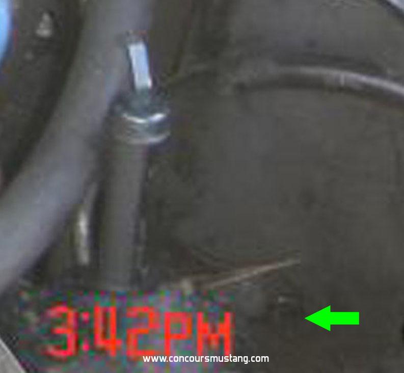

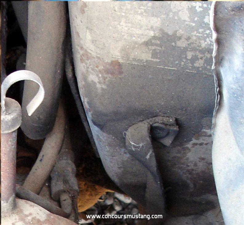

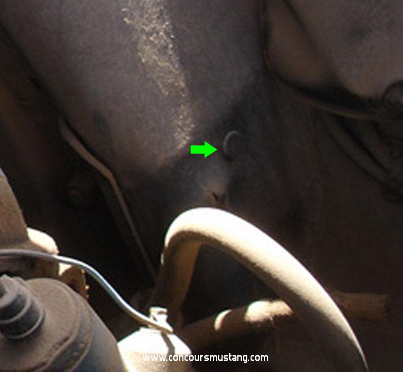

This was easy since these were already selected out in a different part of my files (not in each individual VIN)
Found both metal and plastic versions
7R02C1648xx
7R01C1680xx
7R01A1693xx
7R01C1897xx
7R01A1900xx
7R01C1956xx
Lower strap while we're sort of on the subject ;)
7R03C1883sx

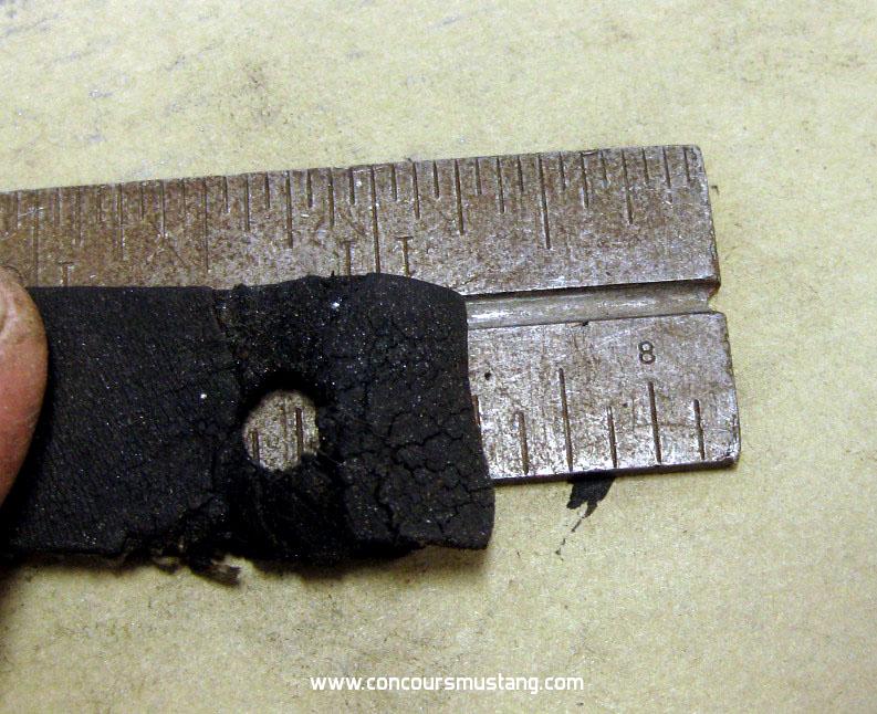

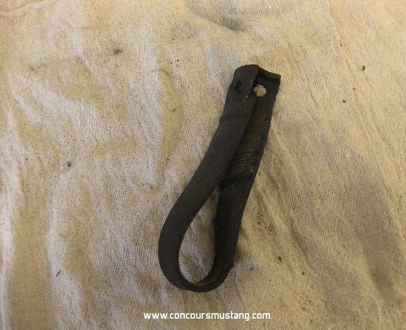

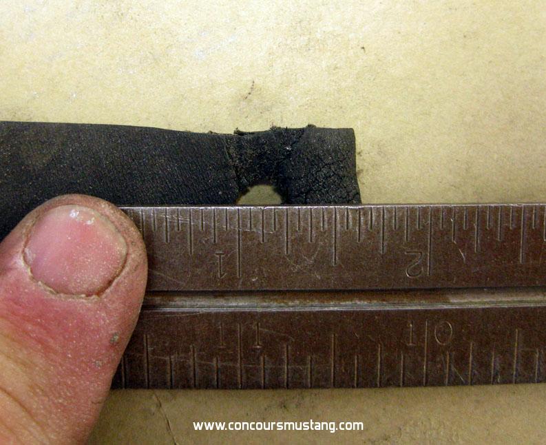

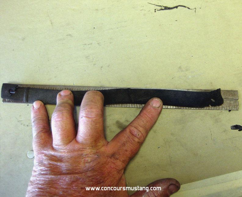

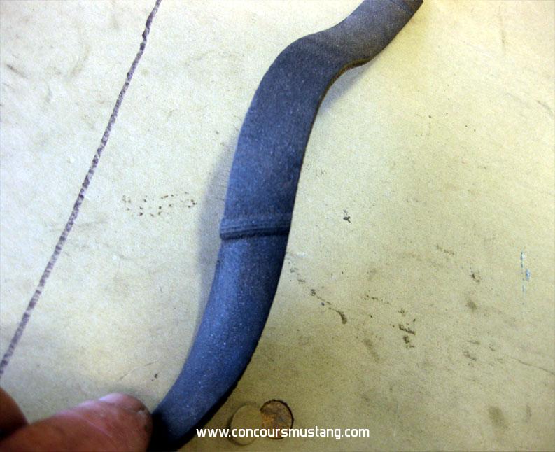

« Reply #5 on: September 08, 2016, 06:07:25 PM »
And I just happen to have measurements from another. Interesting it has the same "bump" from the side wall detail of the tire casing in just about the same spot as your example
Looks like about 11 1/4" long
Reference for hole size and offset from end
Second side wall detail in another location
Did these while I had one handle a few years back- just waiting for an opportunity to post. Thanks for that opportunity  :)

Jeff : Thanks. I knew that there was something like that used on the heater hoses.
I called NPD and had them pull, and measure the strap. Good thing, it is made of tire cord ; bad thing, dimensions "close, but no cigar". It measured 10" long, 1-1/8" wide, and 1/4" thick. Actually quite a bit different than John noted in his opening Post.
Looks like I'll be getting the corded sheet, get out the shears and the hole punches.
