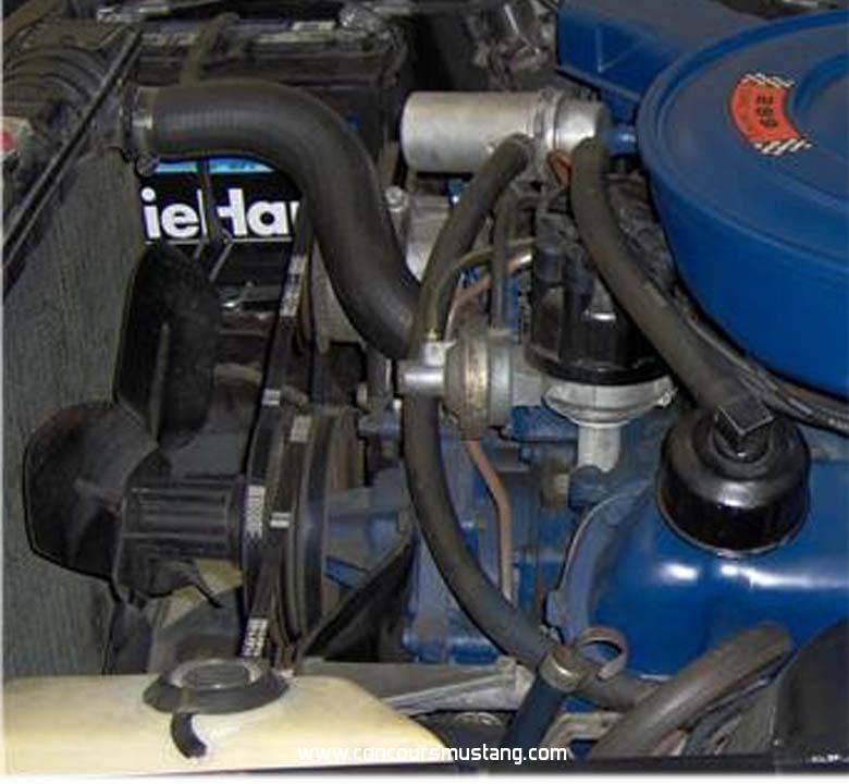

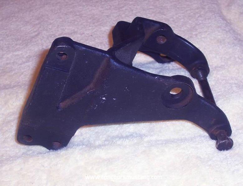

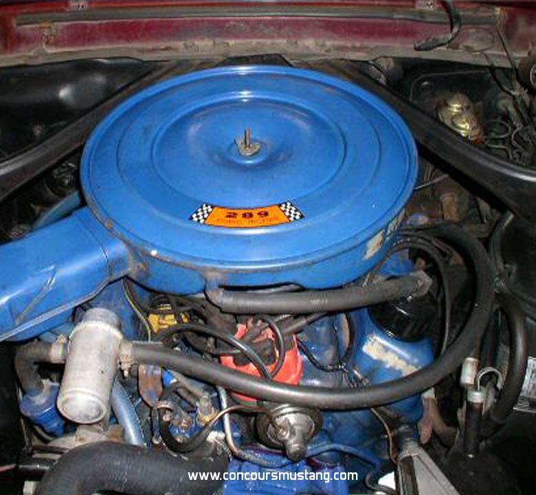

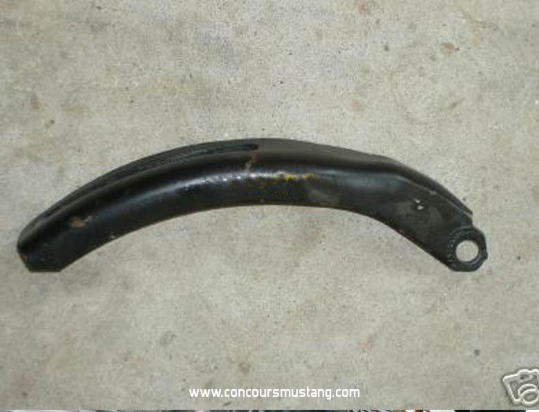

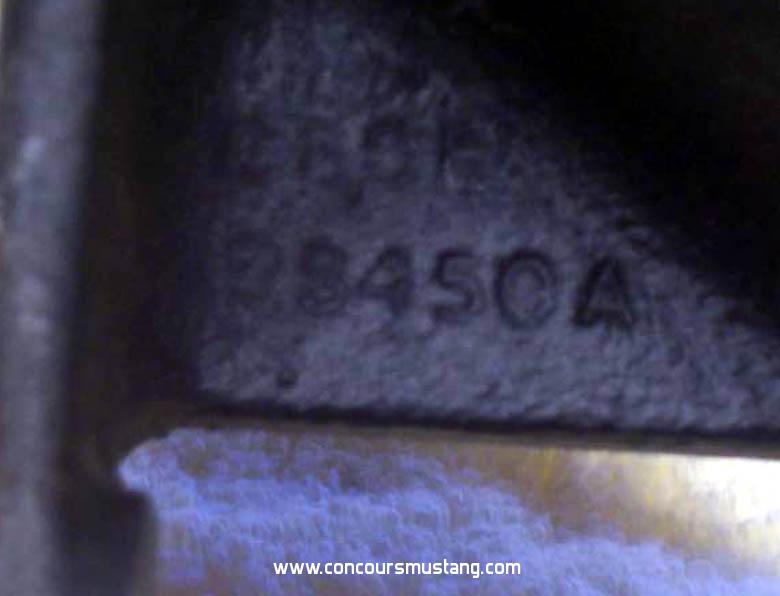

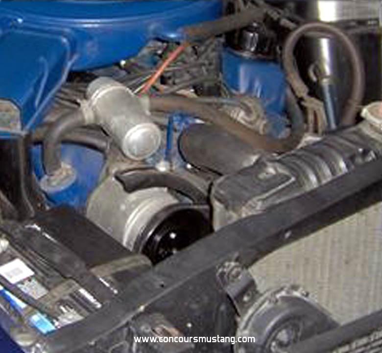

Some pictures that may help with details. Unfortunately no real good unrestored examples :(
Hope these help in some way. As far as belt guess you've already checked Kevin Marti since he is the major supplier of all reproduction belts at the current time. Guess you may have to start looking at the service replacements
Pump bracket
Pump bracket part number - C8OE
Pump adjusting arm
Internal 68 small block system - all San Jose examples

Jeff, any pictures of 1968 302 engines?
The 1968 J code 302-4V engines that I have seen with thermactor smog, had individual smog tubes for each cylinder drilled and tapped into the cylinder heads.
289 smog cylinder heads have a single tube that mounts to the end like in the photos above.

Jeff,
Those pics (especially the last one) is going to be a big, big help to me.  Thanks
