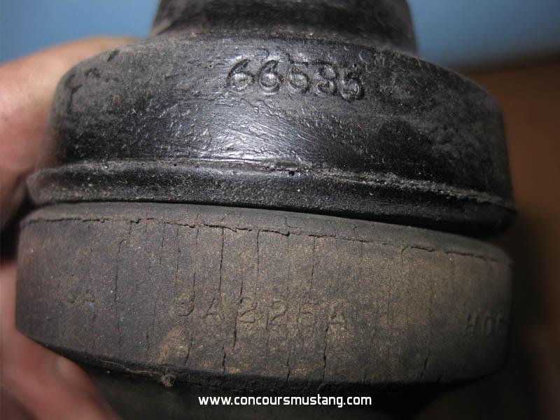

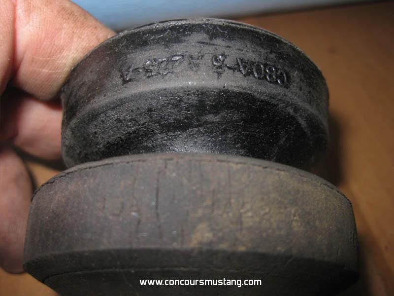

C8OA-3A140B rubber insulator markings
Inverted T and a HOC (possibly supplier) markings
Engineering numbers
C8OA-3A225A rubber insulator markings (bottom most is the original)

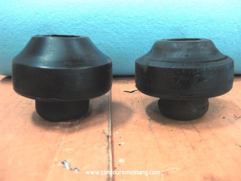

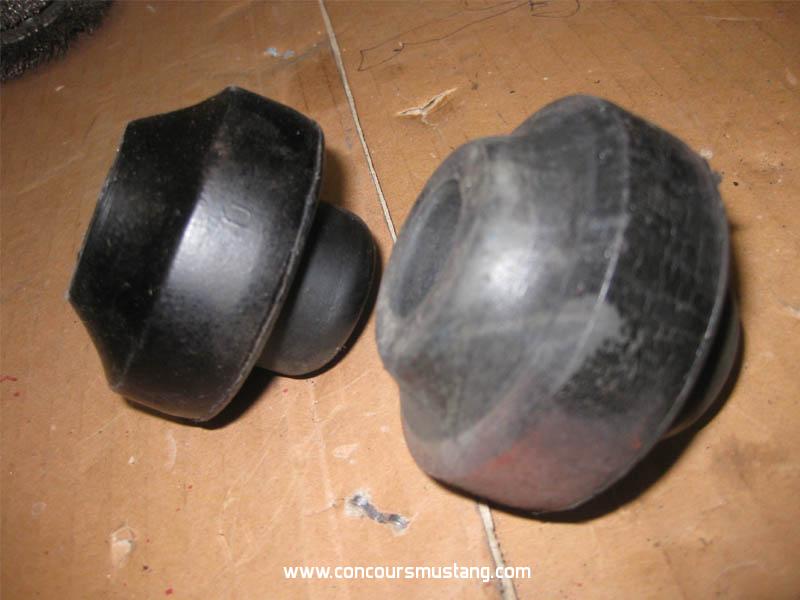

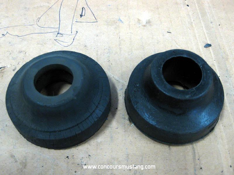

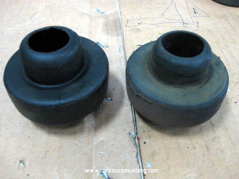

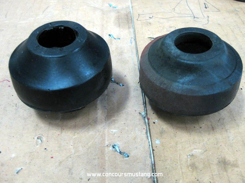

When I removed my original strut bushings and replaced them a few years back and I did a few pictures of them side by side with the reproduction I choose at that time
Not sure what they used to make the reproductions from but here are some pictures
Second rubber insulator/bushing As you can see a difference in height or thickness depending on how you have it positioned. Not sure if the consent pressure/compression from being installed deforms the shape over time just comparing the two.
Markings were different in a couple of ways.
