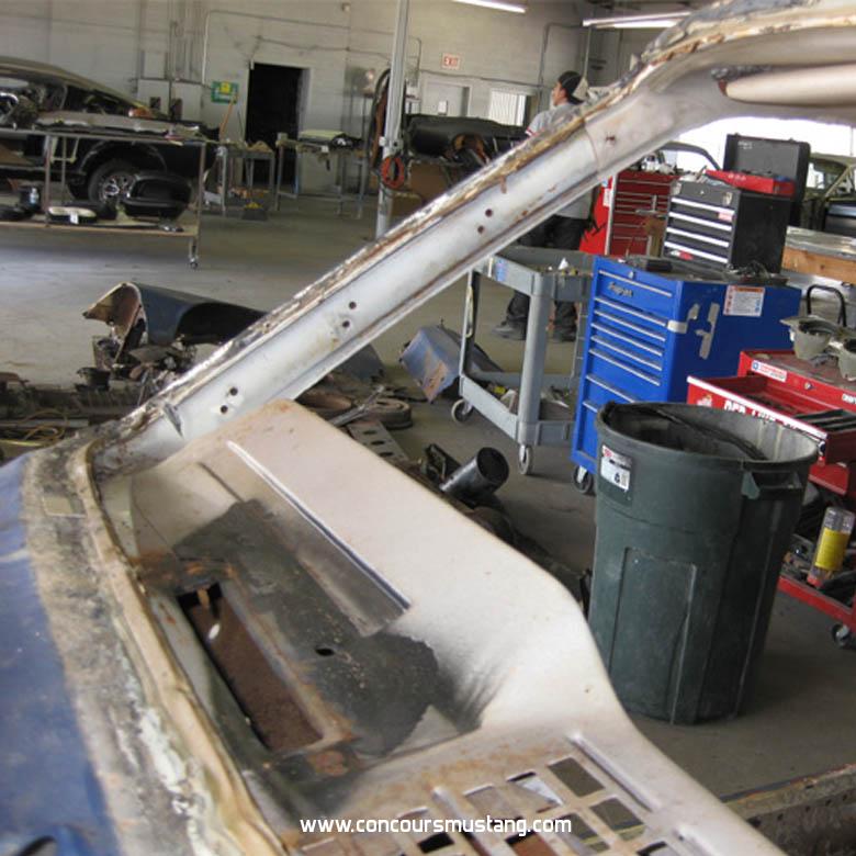

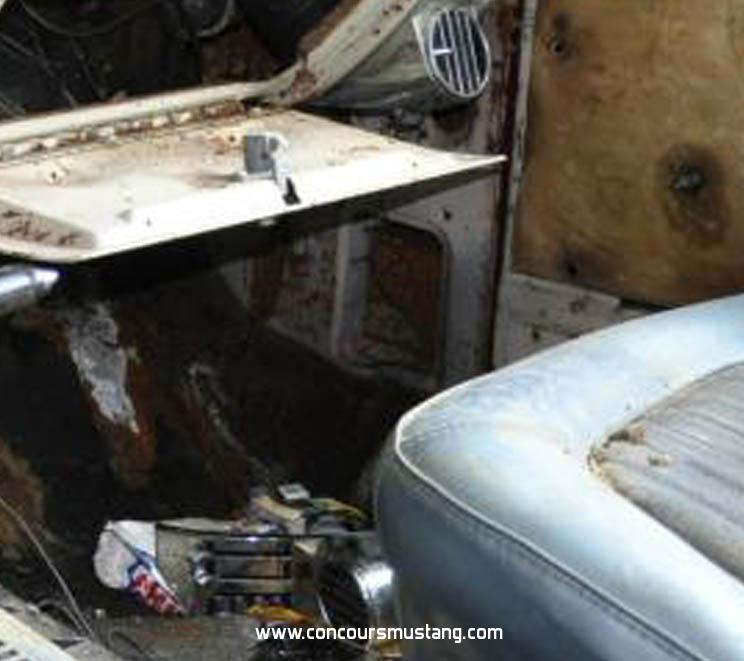

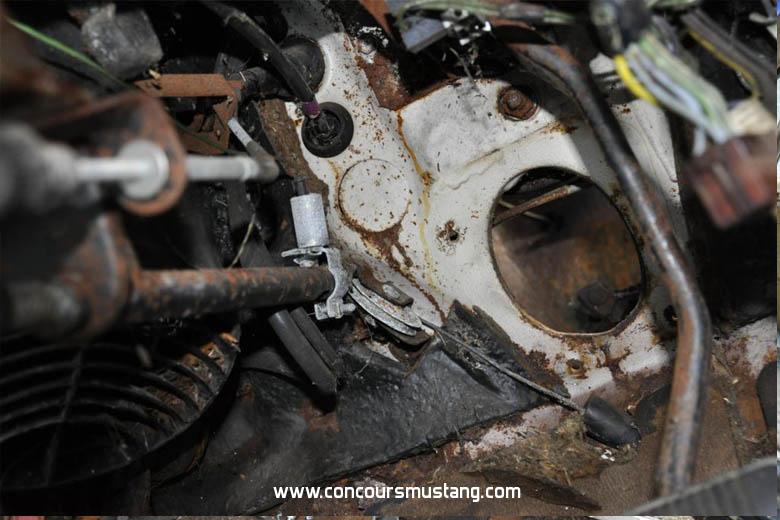

Behind the dash and above would be smooth bare metal. Vertical surface below the dash  a mixture of bare steel (especially in pockets and behind the structure panels) and/or a light, often incomplete coating of red oxide some overspray from the dash painting and minimal to none body color. Often the kick panel area shows a fair coat of dash color from that application
White interior - red exterior example
Top of the dash is often unpainted or thin coats of multiple colors/spray where the painter only painted the dash on and near the surfaces that would be visible- The face of the dash. Along the front edge (covered by the dash pad) would have maybe 3-5 inches of body color from painting the windshield opening. Defroster opening areas were blacked out after body color was applied Could be done with a brush or spray

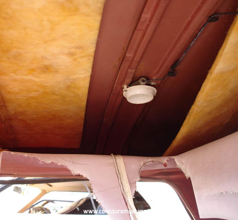

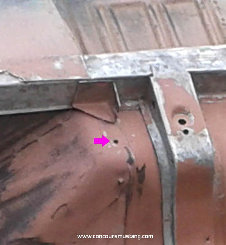

Often some light amount of red oxide but often 50% or more bare new steel. In some examples where is a nice coat of red oxide with no body color overspray Some body color can be see along the areas just inside of the roof railing that would have been painted with the body - leaving a shadow from the roof rails
Here is a 67 San Jose coupe example showing a nice full coat of red oxide.  Again this same area was often skipped

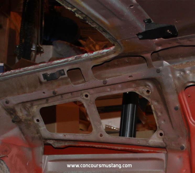

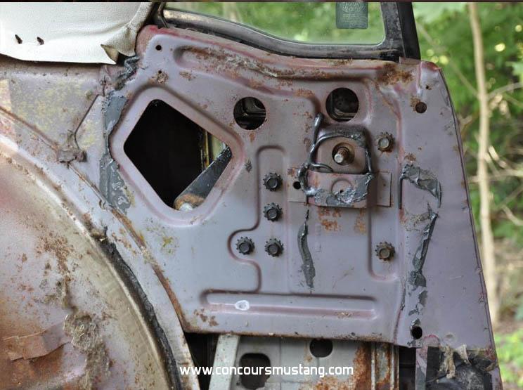

5. Rear quarter panels - by the vents and front of wheel house what color and is it solid or just a mist coat?

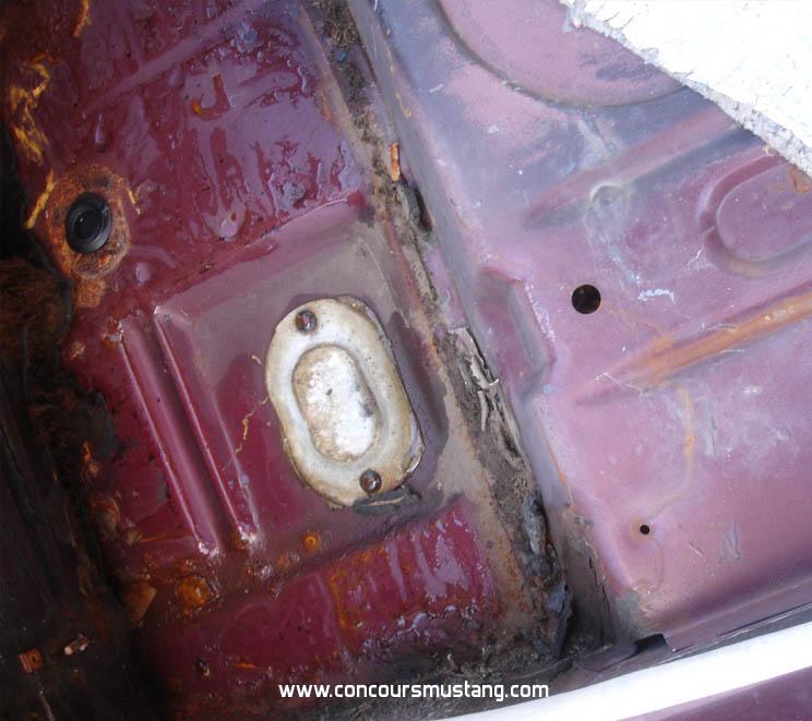

Allot of bare metal with often a misting or red oxide from an attempt of painting the inner structures.panels
Example from San Jose though it illustrates the common mixtures of colors and misting on many of the hortizantal surfaces found on the interior.

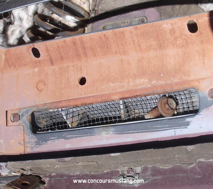

Light coating to decent coat of red oxide fading away as it gets towards the roof. Can have a little misting of body color with some settling long any horizontal surface
Example from San Jose though it illustrates the common mixtures of colors and misting on many of the hortizantal surfaces found on the interior. Ignore the red oxide rattle can spray someone added on the fastback
