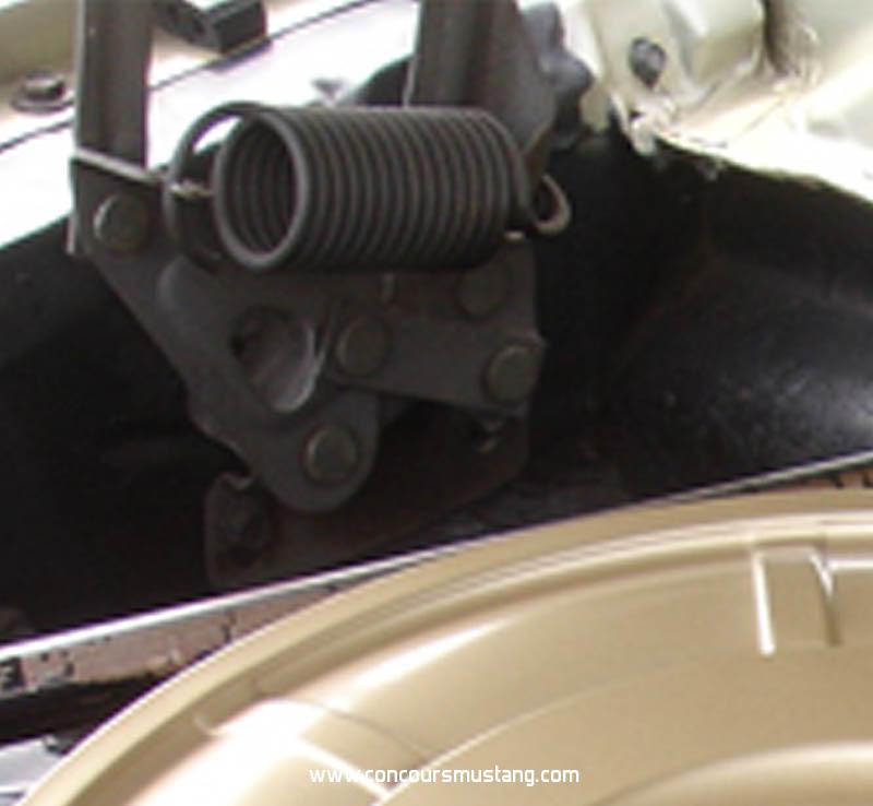

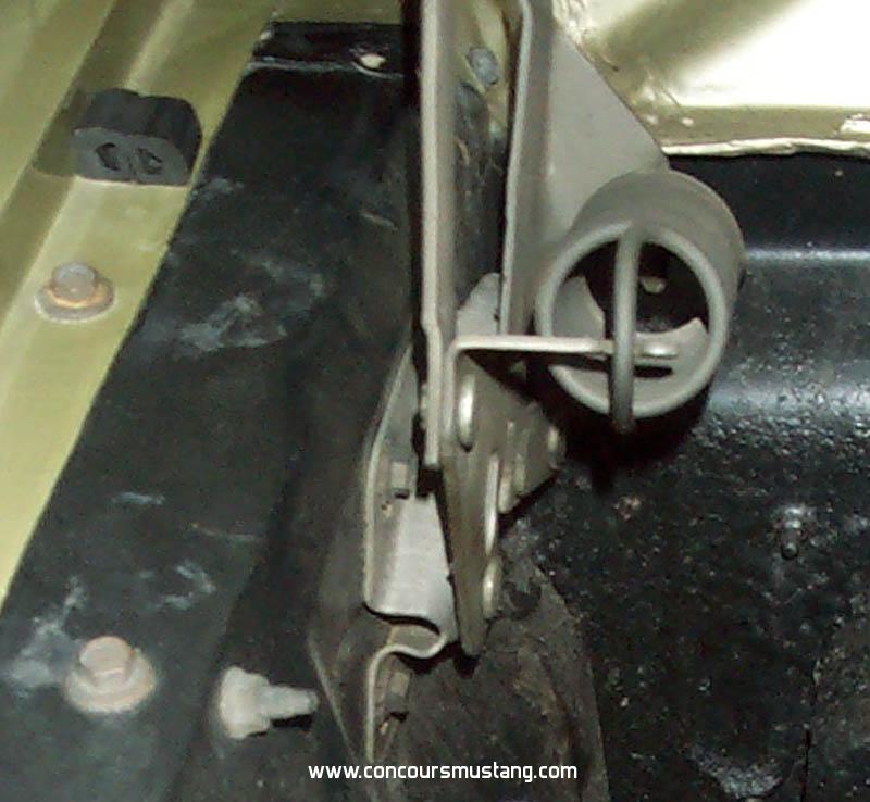

Wouldn't suggest using the gun bluing to try and pass for phosphating on such a large part. These likely will not truly represent what they would look like in person but here is a shot at trying
Here are two of the same hinge from one of Mike's very well preserved cars. 5F08C72755x
Different angles and lighting
