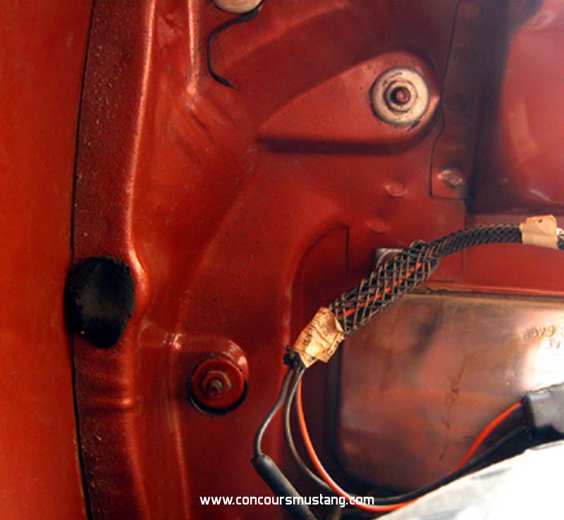

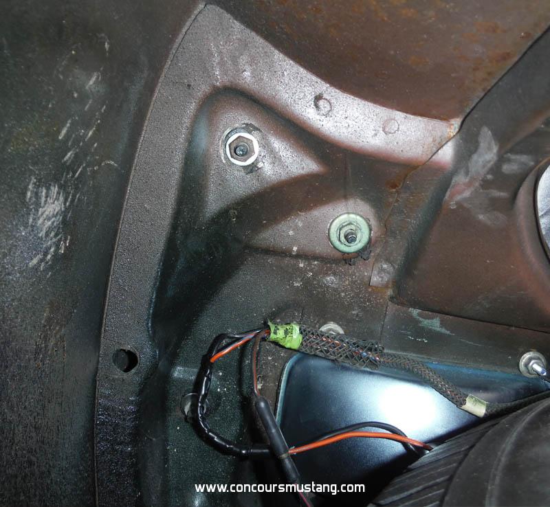

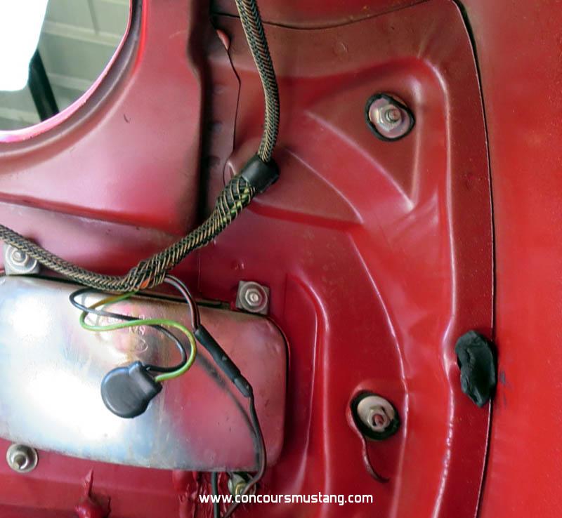

Sorry can't provide suggestions for AMK kits. Rarely if ever purchased them. But can at least offer style and finish pictures
Pictures are from the time period you identified. Location of wire loom retainer and if it was on the car before or after paint differs depending on what part of the assembly year the car was built
On driver side this is the arrangement
On passenger side this is the arrangement
Missing the empty hole dum dum
Both side stud ends are partially painted as well as at least one retaining nut So it looks like you only need 5 nutted washers

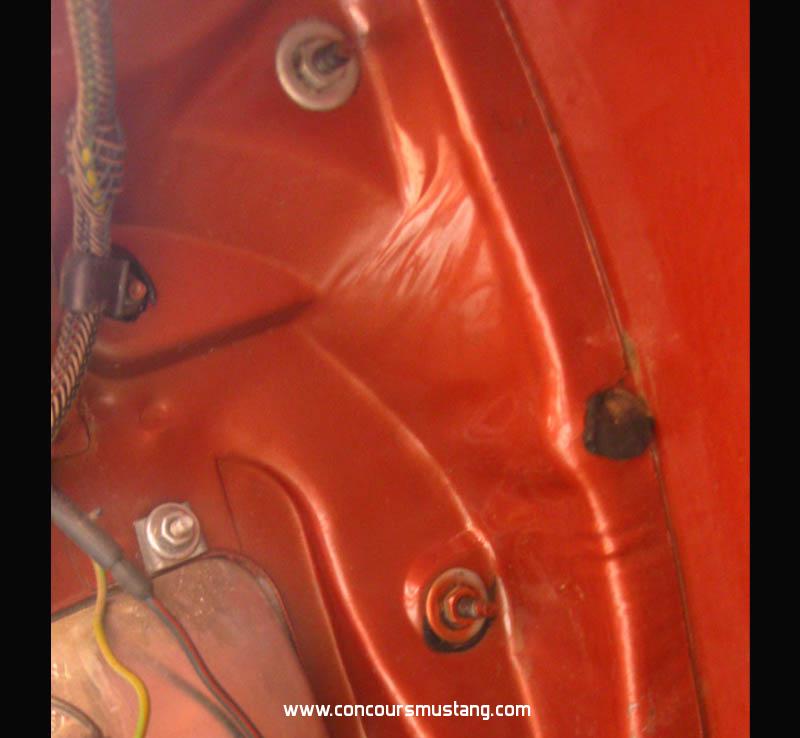

Referencing the thread on the body end cap stud at 12:00 high from the 't' in the "mustang" portion of the copyright/watermark.
I gather this car is original? It appears the nut for the end cap was originally much further out when the interior of the trunk was painted. This allowed the cap to be some distance from the body when the outside was painted. Then when the paint was dry, the cap was screwed onto the body removing some paint from the threads of the stud and leaving this telltale mark.
Do concours judges look for this type of detail while judging?
Not sure where in the thread we discussed the markings on the end cap stud. Don't recall a marking but will look out in the garage just went through a few the other days to find a good match for a car
Yes as already mentioned in this thread a a few others were I described the San Jose paint process in the trunk . Of course this does not relate you your car ;)
The cap often had to be removed (depending on year) to install the seal and reinstalled with all hardware and tightened. This can result with the painted nuts both ending up on the same time in rare cases and no painted ones on the other side.  Sure if the worker dropped one they didn't take the time to chase it down just grabbed another. But again if you don't have pictures from your original paint car to back up putting the car back that way go with the normal/ typical patterns found on the vast majority of cars would be my suggestion.
Yes all the time but not on cars like yours. Its a fairly often missed detail but people/restorers are getting better due to threads like this. Same thing happened with the door paint details and many other examples.

I'll try this again.
Using this pic (see, I kept the copyright!):
The cap was installed on the car, but the nut only went as far as the yellow arrow. This allowed the cap to be almost a 1/4" away from the car body.
The car was painted.
The nut, washer and stud from the yellow arrow to the green arrow was painted as well.
The paint dried and someone then tightened the nut, leaving the unpainted area between the yellow and blue arrow.
