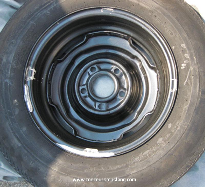

Looks like the answer would be semi-gloss black. IMHO slightly more on the shinny side most of the time

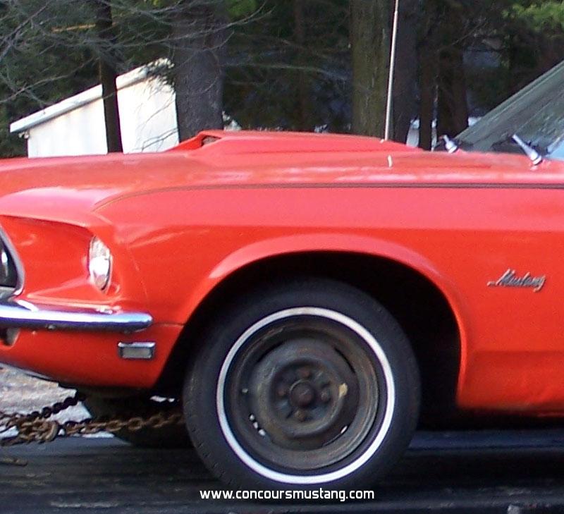

And to help with the full story. If the car was ordered with the smaller (not full :)  wheel cover but instead what some may refer to as dog dish hubcaps the wheels were painted body color on the exterior surface but still semi-gloss black on the rear face.
In this example you will notice that the wheel shows scares around the rim. The car was originally built with the small hubcaps but the original owner whated and paid for something else so they were installed from the dealership.
Hope this helps and is productive for the PO's and others

Thanks You guys.  The steel wheels I have are on the shiny side of black. Actually I would say gloss black is more correct.  Unfortunately the Marti report just says wheels covers.  Thats all I can go by. Just wanting to get the correct color under them.
