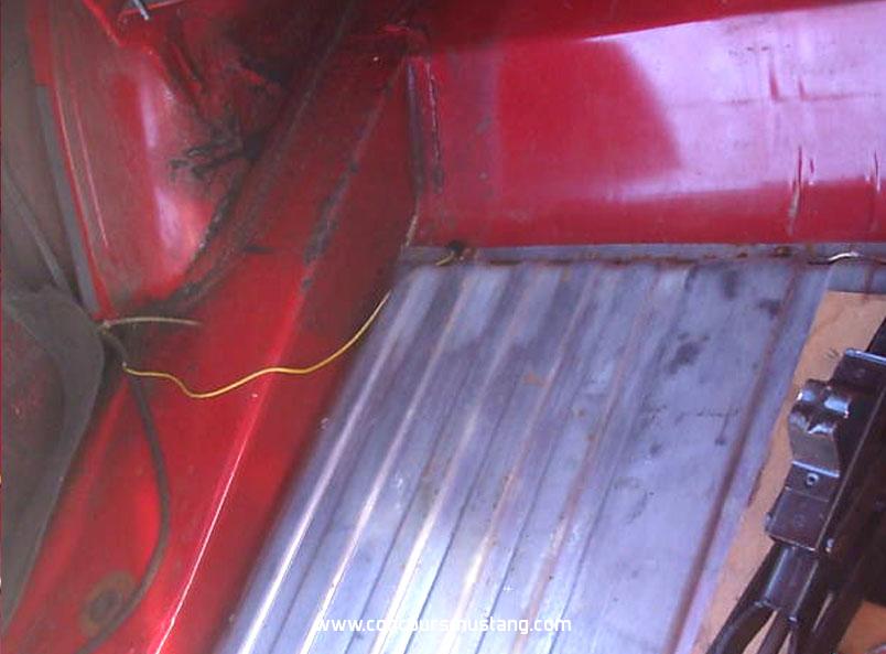

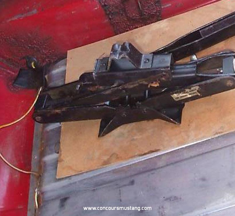

Looks pretty standard across the year for this particular application at Dearborn. Not allot of cars in pictures with the spare, trunk mat and other things out of the way. Below are a few examples I found. Note that some of the other wires have been moved around so don't focus on them.
Wire to fuel senders ran from nylon zip tie anchor at the drivers side trunk and wheel well house across the front edge of the gas tank (retained by rubber coated looped retainers) , then to the hole with grommet at the passenger side trunk floor forward end as shown

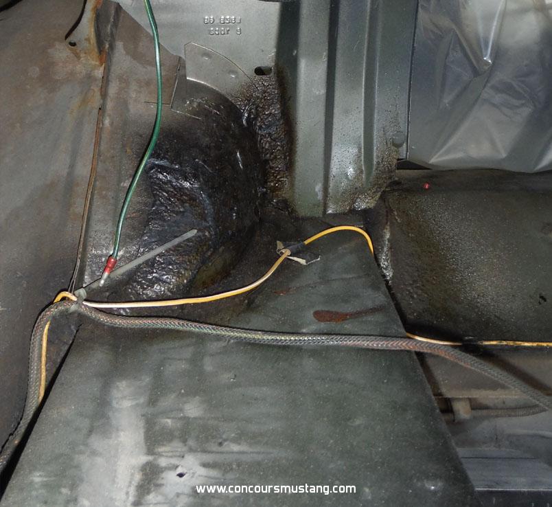

Different body type but similar practice. This time with a small section of gaffers tape on the drivers side trunk floor. Trunk lamp wire has been unplugged and taillight wire disconnected and pulled away from where it was originally
Not sure if tape is attached or just fell over there since there is a wire retainer that goes to the forward passenger side corner gas tank retaining screw
