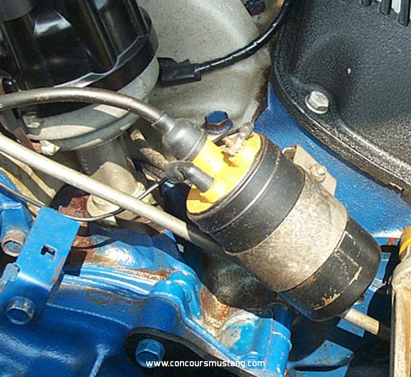

In ChrisV289's picture he shows an eyelet and a yellow 90 degree connector on a 65/66 car's coil.
I think this means the yellow connector is going to a 67-up distributor on Chris' car and that the normal nut screw down for a 65/66 distributor primary lead is instead the ignition power on this car.
Do I have this right?

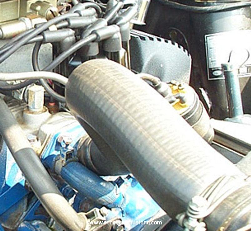

« Reply #5 on: February 18, 2019, 06:03:48 PM »
Took some pictures of the distributor and as suspected it is not the original one for this car.
+1 :(
Sorry Bill don't have any 67 Hipo dist to measure or to offer for comparison.
Did go through my picture collection and none of the period magazine or factory pictures of that area are clear enough to offer any clues IMHO so checked out the cars and found than none of the unrestored cars pictures I have of 67 Hipo engines showed a angled molded boot but instead the eyelet earlier (65-66) style. Below is one of the best preserved GT350's I've seen for your review. It was built well after your car was for reference
« Last Edit: February 18, 2019, 06:26:00 PM by J_Speegle »
