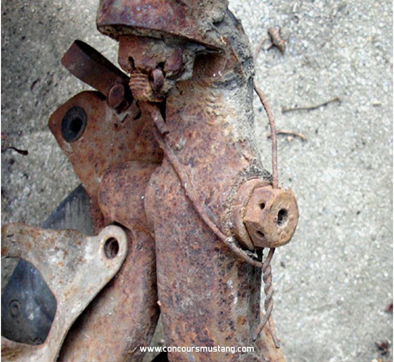

Another example shows the way the wire was wrapped  unique to big suspension 69/70  Shelby's and Boss cars.  The twice around the spindle seems to be a identification indicator. Just to be clear this was done BESIDES the seperate safty wire in the bolts. Bob

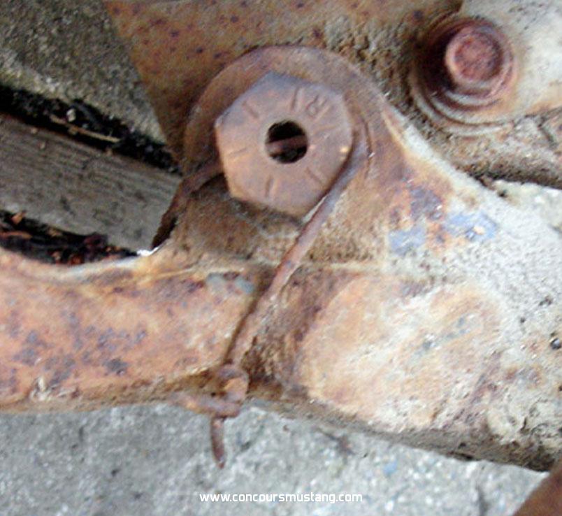

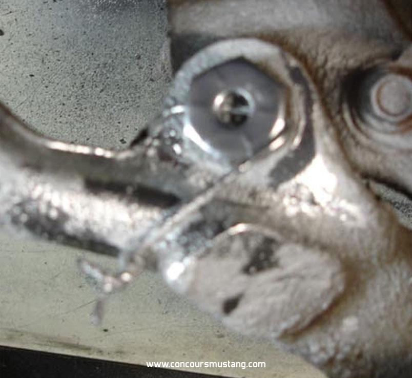

Been over ten years since this thread was last posted to but ran across some pictures (posted in another thread) that I thought would help here. Was going through the safety wire pictures looking for ones to use for another thread
Hope these helps
Believe these are 68 though off the car so can't be certain of which plant they were done at
