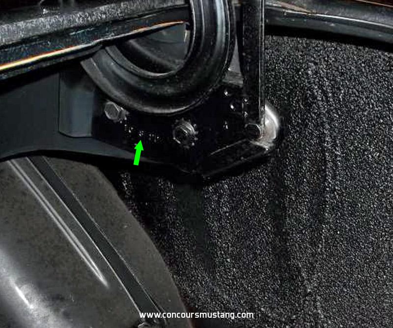

« Reply #9 on: November 08, 2023, 12:24:56 AM »
Is that a plastic bushing at the top? How do I figure out if my car ever had one of those?
I suppose they are unobtanium?
First if your passenger side trunk hinge is original (check the date code) the hole for the spring would be larger and round. Worn holes are often larger but not round.
Also compare other cars built at the same plant, same production period and hopefully same of close date code on that trunk hinge
Chris/ChrisV289 car is a San Jose example.  Sorry we haven't done or been asked that I recall to do a survey to help determine around when the change took place as we have for 65 San Jose built cars but the hinge dates should apply since the same stamping plant supplied both plants I believe.
https://www.concoursmustang.com/forum/index.php?topic=27123.msg166398#msg166398
So while I look for examples built around the same time period and plant as your car can you provide the date stamp from your passenger side hinge? Hinges dated the same should have the same design we would expect until something solid is found to challenge that notion
« Last Edit: November 08, 2023, 12:27:06 AM by J_Speegle »

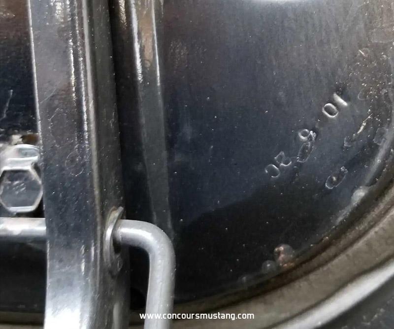

Didn't find a date code on it?  One below is dated 10 for the month = October

« Reply #12 on: November 09, 2023, 05:09:31 PM »
Date on my hinge is 9 11 2D.
« Last Edit: November 10, 2023, 09:56:09 AM by jtfx6552 »
1965 Mustang Fastback, October 29, 1964 Dearborn Build, In the family since new.
Re: Trunk Spring Question
« Reply #13 on: November 09, 2023, 09:19:44 PM »
Date on my hinge os 9 11 2D.
Thanks With that date on the hinge and the correct design for that period, welded stops and so one, we have others from the same period at Dearborn to confirm it very likely was made for the bushing like the one below of 5R09C363xxx.
