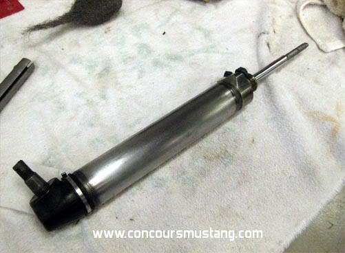

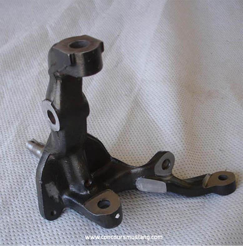

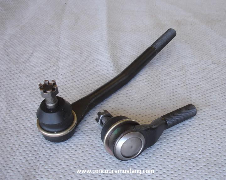

Using gun bluing is tricky and can get expensive. The trick is what to do after you've applied it. The phosphate process uses oil as a final surface treatment and I don't see why it can't be used after gun blue. I have a couple of black powder revolvers that I made from kits years back and the bluing is still rust free but they were not subjected to moisture, are cleaned regularly and oiled. Parts that are heat treated should be darker in shade, almost black, than a natural finish. That would apply to the forged arms and to the accelerator bar (springs, tie rod ends, spindles too). I use the metal blackening concentrate from Eastwood to get a dark shade prior to the phosphating. For a more natural looking steel, a shortened dip in a phosphate bath, two to three minutes, with a lower amount of the phosphate concentrate followed by steel wool, single 0, then oil it (WD-40).
Re: Finish confirmation on a few parts
« Reply #6 on: May 30, 2012, 01:11:28 AM »

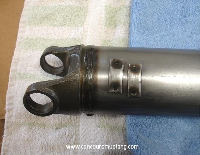

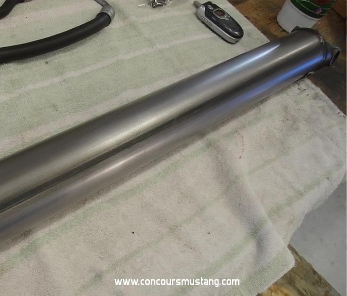

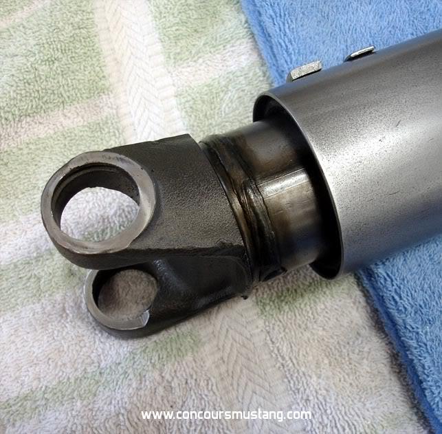

The "gun bluing" that is typically used in these applications is the application of the "repair fluid" not the real bluing process. Because of this no heat us used, it takes seconds and can be treated (like P & O ) with any of the oil process for a long life (well as long as any other oil coating holds up.  Sicne it does not use heat its a good IMHO choice for many items such as ones with rubber boots or unsealed items like tie rod ends. Tim did a nice class at the MCA Judges meeting two years ago where he refinished pieces in just minutes at in front of the judges.
The tone (darkness) can be adjusted by the method of application of the fluid and  how it it handed after. Steel wooled, burnished,  tumbled or left alone can all produce different appearances to reproduce the original heat treated or even phosphate - I've been using it on show cars since the 80's . Not the only choice just an alternative many are using.
Also works great and reproducing the bluing welding produced on original parts (PS rams & drivelines are two examples of this)
