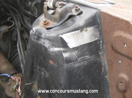

Service decal - Guessing you have a non AC car since that was not mentioned. Drivers side shock tower forward face high or low

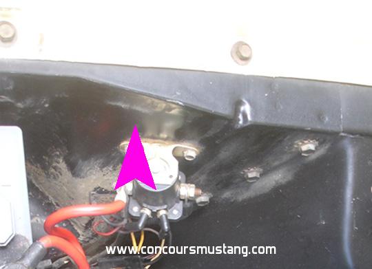

Battery inspection decal - located over the starter relay. Unfortunately the decal is not available correctly from any of the big vendors. Corect one for your car would have blue printing rather than the currently available black printing

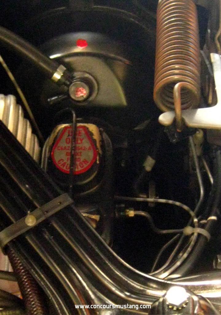

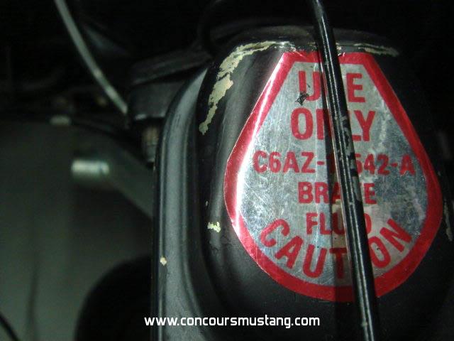

Master cyl cap decal - (guessing you have Power disc brakes) Brake fluid warning due to your build date.

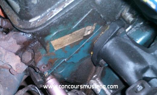

Engine ID decal - Applied to the passenger head - front surface

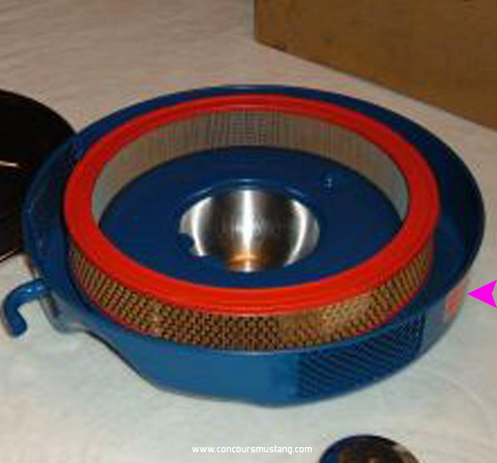

Air cleaner - Again guessing that you have the air cleaner base without the snorkel but instead the two screens (one on each side of the filter base ) and the elbow at the front (about at the dist). Correct??
Top CU Decal
Side AUTOLITE service replacement decal - arrow

I had ordered the '67 Decal package (from ECS) a while back, and as I was going through some of the "documentation" photos of my car today, I noticed a detail I had missed with the Service Specifications sticker that goes on the driver's side shock tower.
The sticker included in the ECS package (FSR-138 - see first attached image below) looks totally different than the one that was actually on my car.  After a little research, it appears that the sticker on my car was a left-over from 1966...
Does anybody know when the San Jose plant switched from the 1966 sticker to the 1967 version?
