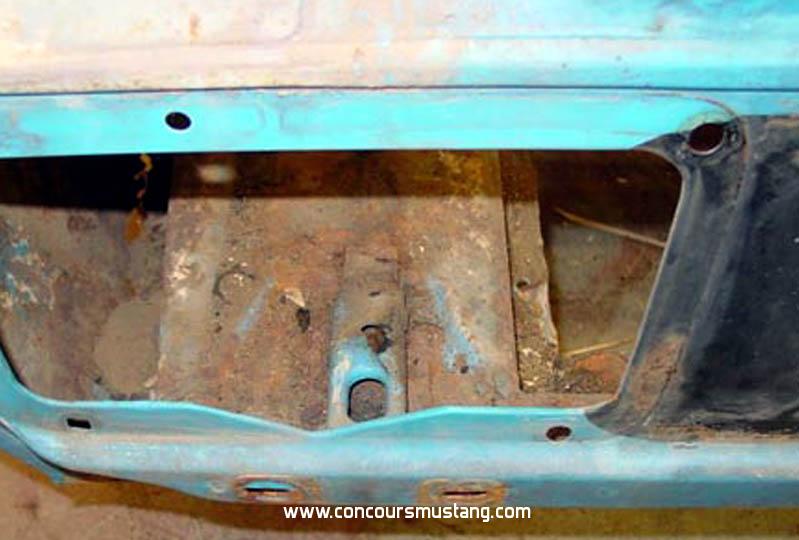

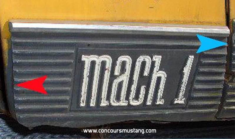

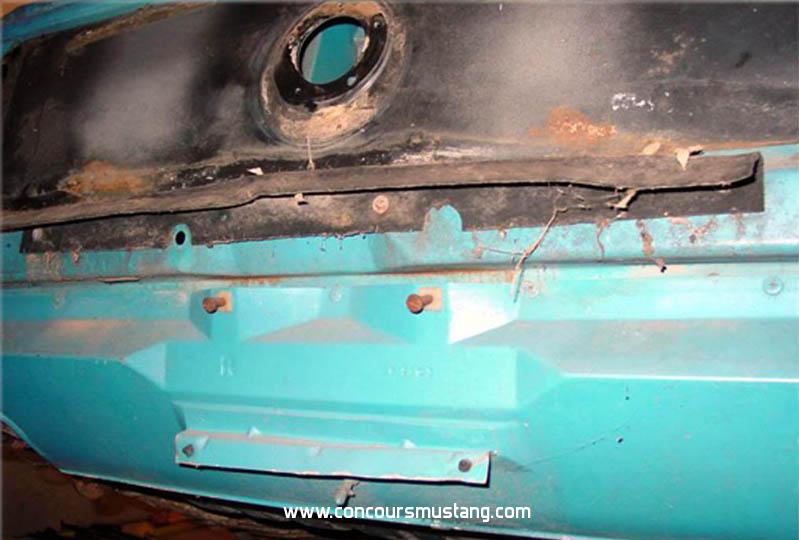

There are what appears to be three areas of the body that were handled differently on 70 Dearborn Mach I's

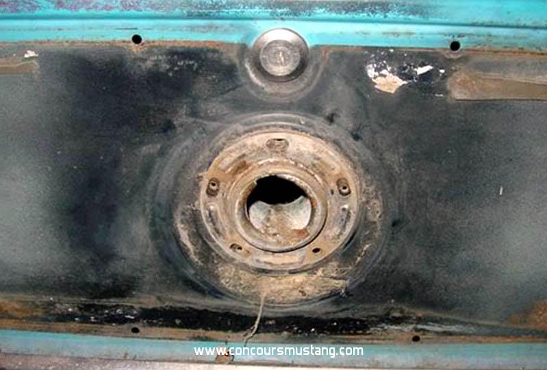

One was the taillight panel where the paint received a coat of black paint between the taillight openings. The effect blacked out the gap between the taillight housing and the applique panel as well as the gap between that panel and the trunk lock bezel or trim surround

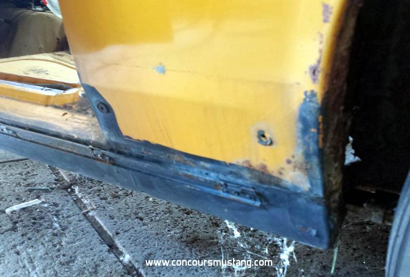

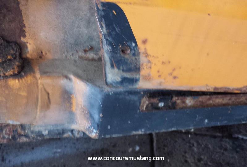

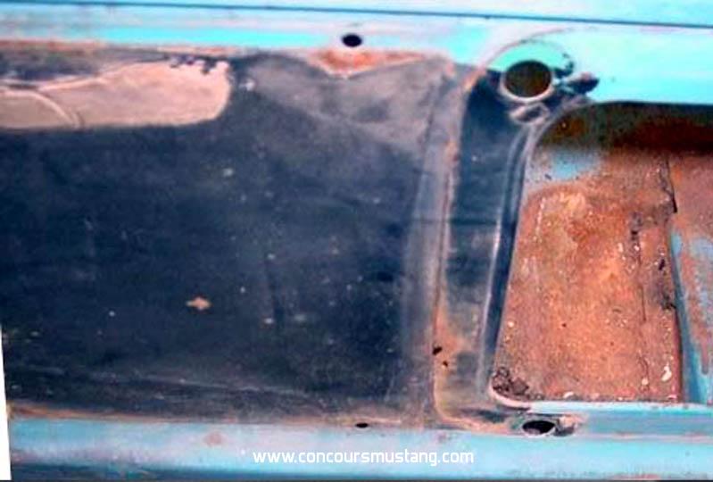

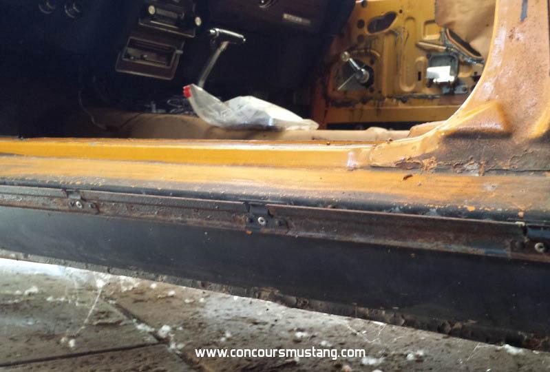

Second black out detail appears to be a difference in the height of the normal pinch weld black out. Instead of stopping on the bottom horizontal surface of the rocker  they applied it much high to about where the side cladding would be attached.

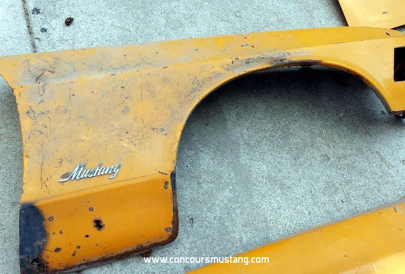

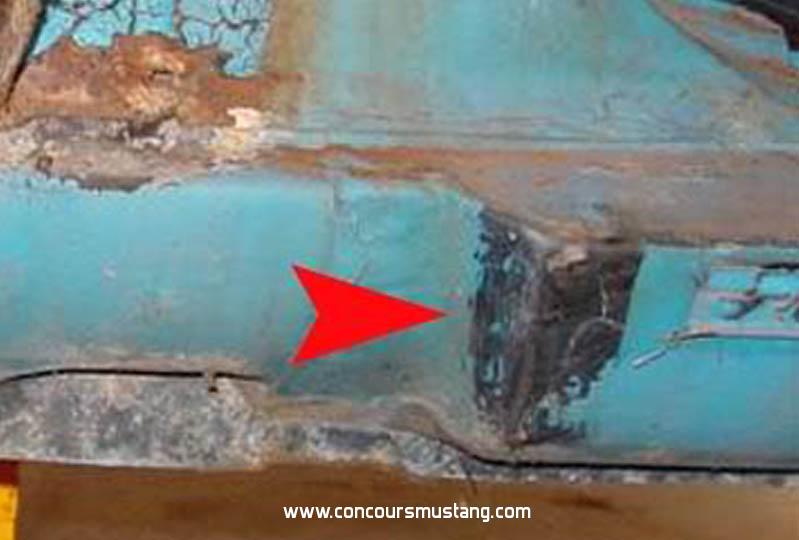

Thirdly appears to be an effort to black out the gaps between the various cladding pieces attached to the front fender, door, rocker panel and the rear quarter panel. This appears to all have been applied with a brush as shown in the pictures.
So you have
1- Front fenders appear to have been blacked out allot. Looks like a brush and possibly spray to apply and since they were painted (with exterior color) IMHO they were likely blacked out on the other paint line (where all the individual parts were painted) rather than once they were installed on the car
2- Rocker panel (in addition to the pinch weld blackout)

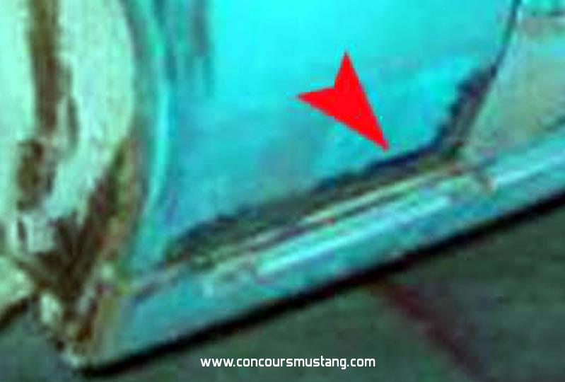

3- Door edges (sorry no real good clear picture of the forward or rear edges painted on a Dearborn car IMHO they were done as they were at other plants) See blue arrow in the fender picture below for a glimpse of the black out. Like the (top of the L on the quarter panel black out) the black appears to stop at or about where the bottom edge of the chrome strip along the top of the cladding would be.
4- Rear quarter panel - basically a big "L" shape on both sides

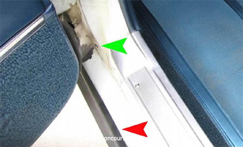

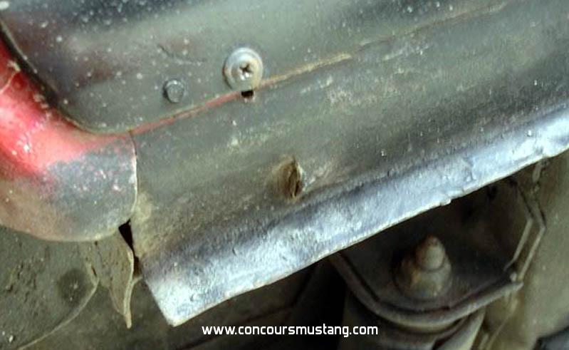

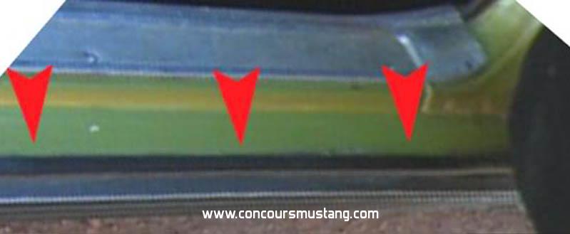

The only conflict I found was the handling of the black out on the rocker panel as it curves into the door opening - towards the sill plate. On three cars I have pictures of the black stops at or near the edge where the panel curves into the door opening and one car it appears that it was blacked out all the way to the sill plate.  Since this is a single finding IMHO it was likely a mistake made by a fill in person or , since this car was an earlier car (117xxx verses 167xxx or 176xxx) it may be something that was changed between the time the examples were built.
Example of the paint break at the edge of the rocker/sill on the "later" cars (Approx Oct - on)
In this one (green arrow ) you can see part of the front edge of the rocker panel black out shown in the other picture
As always - this is based on what I currently have available and my current understanding based on this data. Hope this helps

Took the opportunity to add some pictures, make them more uniform  and freshen a few things up

Jeff, thanks so much for the pictures, they are awesome details and really helps me better understand the different concepts used to blackout the rocker molding area on the bottom of the 1970 Mach 1.

I also have some pictures for tail panel blackout, which show three separate area blackouts as compared to these with have it all black out from light bezel to light bezel, which method is 1970 Dearborn method?

If this is from your early car and the paint was all original copy what you found and make sure you keep the documentation. What you found may be something they tried at first them discovered it was easier/quicker/cheaper just to paint the larger one area
