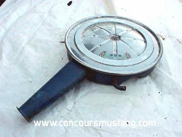

As a note we did have conversations during the time period when the car was being shown.  As far as being original or correct IMHO yes and the reason it is as follows. From what I've seen and owned on original cars apparently Ford had some challenges with the 390 Thermactor cars in the Mustangs since there was a clearance problem with hood and the larger car air cleaners and their attempt not to make specific (sure it saved money) new air cleaners for this application to satisfy California emissions standard (closed element). The T-Bird air cleaner provided the clearance needed, the flow and size needed (with the baffling and all) for the 390. The blue decal is the same one used on the T Bird  that year though the lids on the T bird were painted not chromed. Unfortunately the air cleaner decals don't hold up well over time - especially on chrome lids)  so we don't have a ton of examples to pull from. Not saying all Thermactor 67 390's built at San Jose had the blue decal just IMHO some did
Here is a picture of an air cleaner that was on my 67 GT390 fastback (just for one example) I had in the 80's

Being involved with the MCA 67-68 classes for so long I recommend that you stick with the blue decal. The smog emissions 390 did use the snorkel type air cleaner lid and Jeff was able to provide good documentation to show that the blue 390 decal was correct. When Charles and I judged it for its first MCA National, we did not take off for the decal as we were comfortable with the documentation that Jeff provided to us.

This might make this a little easier ;)  Since you seemed to suggest that it would be easier to understand if the T bird and Mustang shared the same air cleaner and chrome lid I offer the following text from the Aug 67 (right after they stopped making the 67's)  MPC. Second line down
As you can see according to the documentation that the snorkel style air cleaner was shared by both car lines and using both a Mustang and T Bird part engineering number (C7ZF-9600-K & J plus  C7SF-9600-A) for the same part. Apparently there were two different versions of the Mustang one for some reason - recall a internal baffle issue in one of the Tech Service Bulletins that was again shown in a Shop Tips
