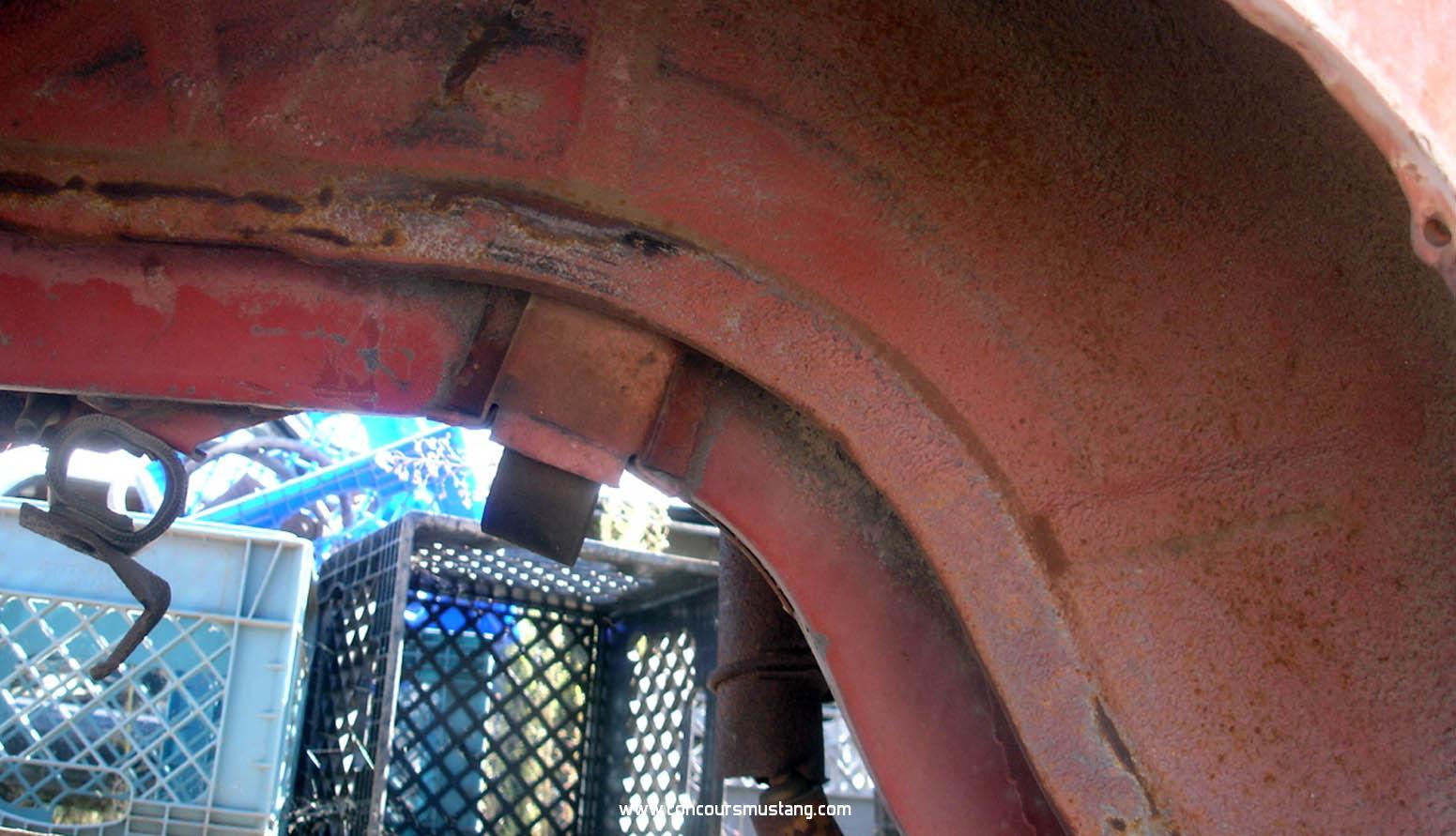

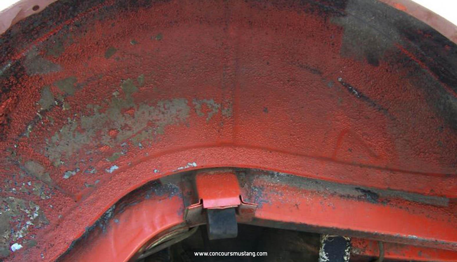

+1 That is what I've got and seen. Often the paint wears away from stuff thrown up by the wheels over the years. Also to add to confusion many owner blacked out the wheelwells with rattle cans in the 70's especially on lighter color cars and in the 80's since clubs/judging didn't want to see body color there in those days.
Check behind the inner fender lips at the top and for body color over sound deadener on the frame rail in the wheel well. Always seem to find at least one spot where the previous owner missed or that has remained untouched by gravel and such from driving. More often than not the condition makes it difficult to tell with out a careful cleaning
A couple of early Dearborn examples from 65 (choose red since they stand out well ;)
5F08D114168
5F07D117308

Thank you very much for the clarification and the photos.  It is crystal clear.  All the plants painted the rear quarter panel in the same manner which deposited the exterior paint into the wheel well over the sound deadener.
