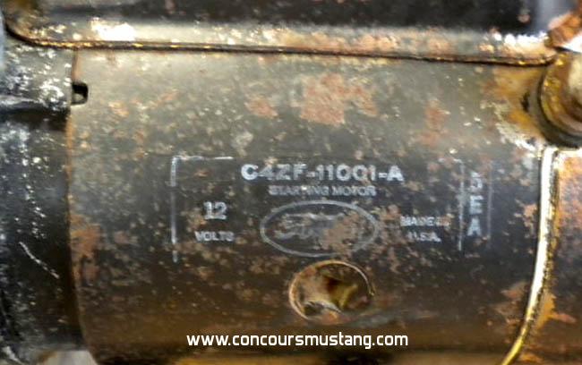

I am guessing this one is correct.  I thought there would be something about starters in Mannel's book but they are strangely absent.

Re: Correct 1965 K Code Starter?
« Reply #5 on: September 17, 2014, 04:44:50 PM »
Looks like a service replacement. Is that correct?
Offline rockhouse66
  • Posts: 958
« Reply #6 on: September 17, 2014, 06:22:25 PM »
Jeff - I suppose it is possible.  Photo taken at Bob P's.  What makes you think so?
'66 GT FB

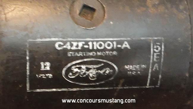

« Reply #8 on: September 17, 2014, 10:17:33 PM »
Here are pictures of the starter on my Aug 64 car. Dearborn, 4v,4 speed. Looks like the one above minus the extra stamp.
The markings
Notice the difference in the other stamping? The "frame" is an interesting detail

As a follow up and in an effort not to start afresh I offer the following.
Had cause recently to spend some time doing the graphics for one of the starter stamps used on early Mustangs and thought I would share
One of the originals - the most complete. And the reproduction, quickly stamped and photographed so I can get to the next project Hard to get the shot from exactly the same angle on a surface that isn't flat and of course size of the individual details depends on how hard you press while stamping. Looks like the original they didn't press very hard on the top edge and let off at the bottom edge possibly before it touched the surface of the starter. Bottom of the frame is much more visible on other original examples
Originally they may have rolled the case over on the stamp rather than the other way around. Will not apply any pressure on the finished product ;)

Is the 5EA on the right side a date code?
« Reply #13 on: April 08, 2016, 02:13:34 PM »
Date and shift
