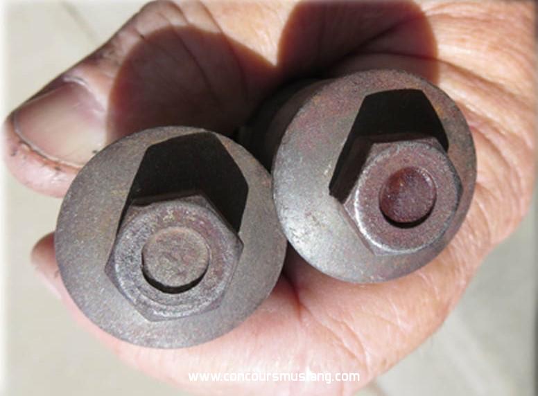

We had gotten off onto 67 competition and 67 Shelby (both GT350 & GT500s)  end link bolts. I have seen what appear to be two different versions of the head markings in the last couple of years as shown below
From a car in the low 300's. Sunken heads with no apparent markings in the center
From a car in the low 900's. Sunken heads with what looks like a N in the center

jeff are they fine thread as I have some early bolts like that & they are fine thread & the later 69 head is corse thread
Re: 67 Shelby Sway Bar Hardware
« Reply #4 on: October 23, 2014, 10:44:42 PM »
Believe that is what they look like - will find them and double checked time at one of the shops. Pretty sure that one set will get replaced with something out of a catalog :(   Not that it matters much on that car.

All of the longer originals I have seen were fine thread. Yes if replaced typically the replacement part If looked up under 67 Mustang would be replaced with the shorter 65-67 style. Not many were intuitive enough to notice the longer version for this special application. If they did and ordered the 68-70 longer version which is most similar it came with the coarse thread .Just my observations.

  Jeff, and all.  My October built 67 GTA SJ car has those same sunken hole heads with no letter so, this just might be an ealy/late thing and not necessarily A Shelby application..
  Bob: it there some kind of length to these?
  • Posts: 9523
« Reply #7 on: October 25, 2014, 01:07:42 AM »
You are correct it is not a Shelby thing but a Ford thing in so much as the hardware identification. The bolt is substantially longer on the longer end link tube version bolt compared to the typical non comp suspension Mustang end link bolt. The makers mark variation may very well be a early late thing. I haven't seen enough to feel confident about making a ruling on what the pattern is.  I haven't put a ruler to the individual bolts recently but they are easily distinguished because one can't be substituted for the other given the end link tube in use.

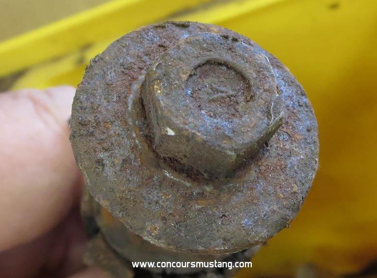

It's actually a letter V, as shown here on my signature car.
Fine thread 5/16x24. It necks down from .365 bolt shaft to .300 (approx) into the threads.
From under the head to tip is 6 11/16".
The Assy Manual says the standard fitment uses an S8 cone nut, S2 washers and an unknown on the bolt. P&O maybe? And the sleeve is what finish?

The bolt is the same length as the 68-70 bolt with the exception that the 67 bolt is fine thread. It is PO. It is not the same as a regular 67 Mustang which is shorter.  I have found the end link spacer tube in what appears to be bare steel. I have also seen some zinc plated spacer tubes but that may be a later service part. The tube spacer is identical to the 68-70 version.

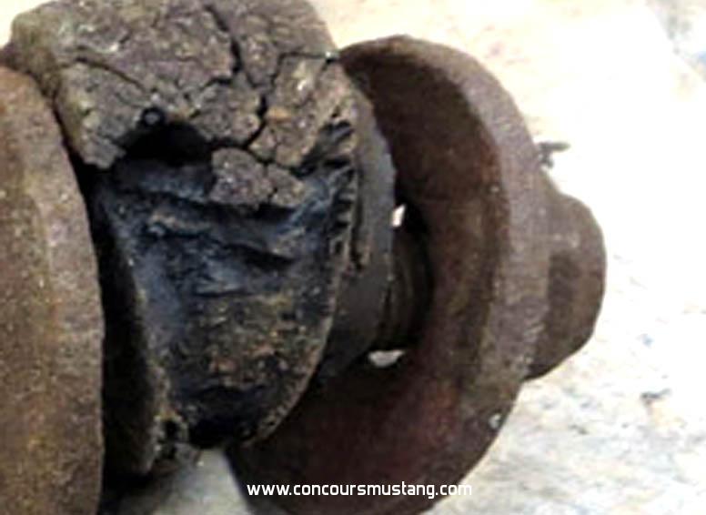

After I wrote this and went off to do other things I found this nut and bolt. Is this the correct one (see pic)?
Should be.
