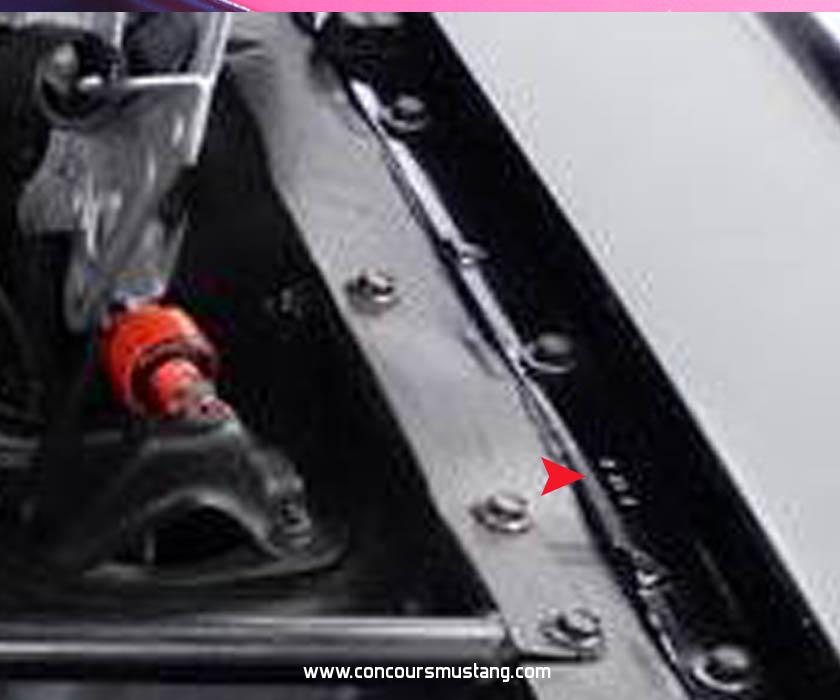

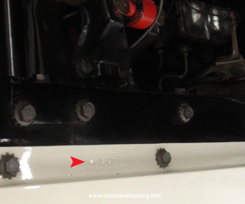

65 - early 66 style fender date location

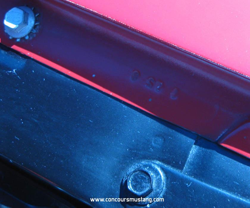

Later 66 style fender date location
