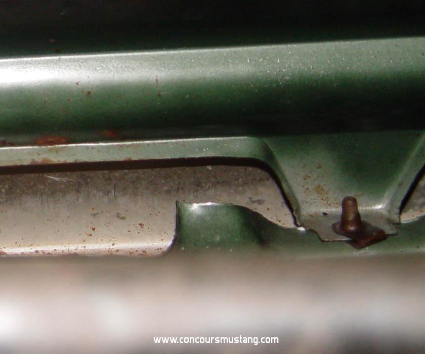

Here is another example of the back side of the same panel (65 Dearborn) with, as mentioned, not much exterior color in the corners and pockets

Looking at your picture, unless I'm missing something, isn't that one green over a grey primer?
Yes - typically applied over the red primer as a primer surfacer to fill small imperfections and pin holes on the areas where the exterior paint was to be applied . Does a poor job of sealing out rust and the like so that is why the red oxide was used also
