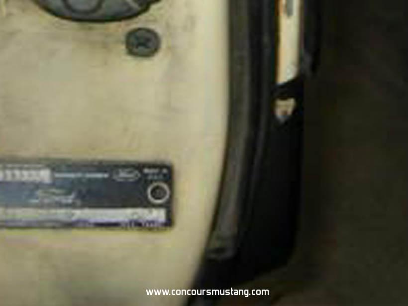

First remember that the interior color (like other years) was applied first then the exterior color was applied with a mask over the area they wanted to remain painted interior color
Not a ton of examples (like other details, years and models) but this should help

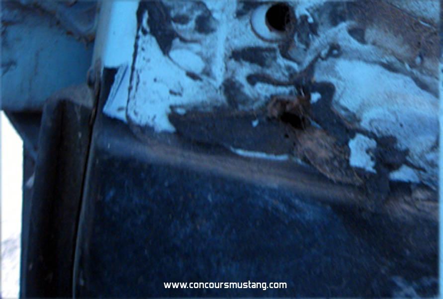

So looking at the files we got luck and found two examples with a couple of angles and it confirms that at least one painter was doing things differently from later in the year.
No good clear of the leading edge but would think its a striaght line to the door edge behind the weatherstrip.

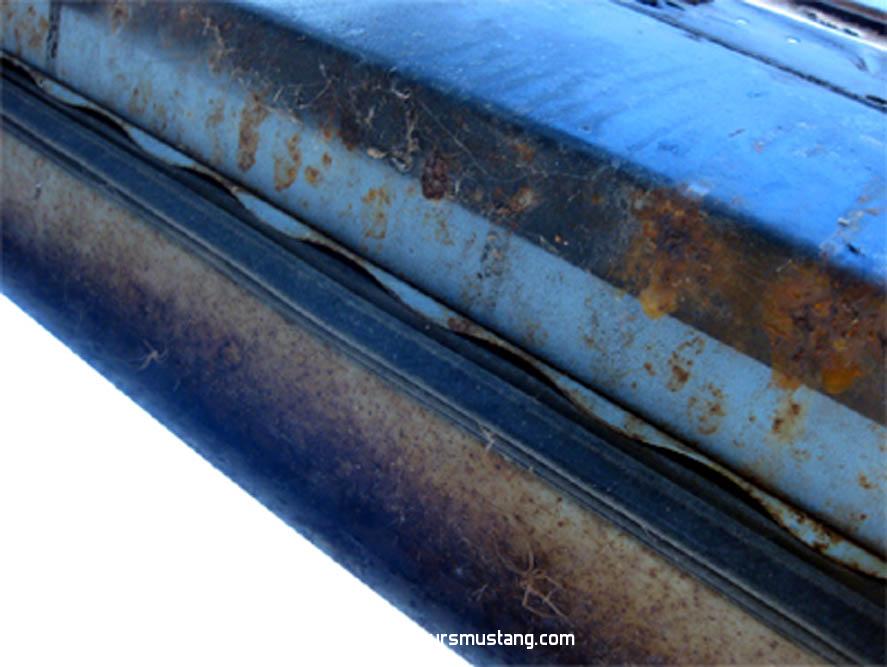

Bottom is as expected about 1" or so away from the weather strip retainer

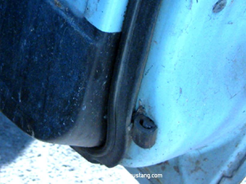

Rear edge (ignore the chip in the one example) like the front. Straight top edge - back to behind the weatherstrip
