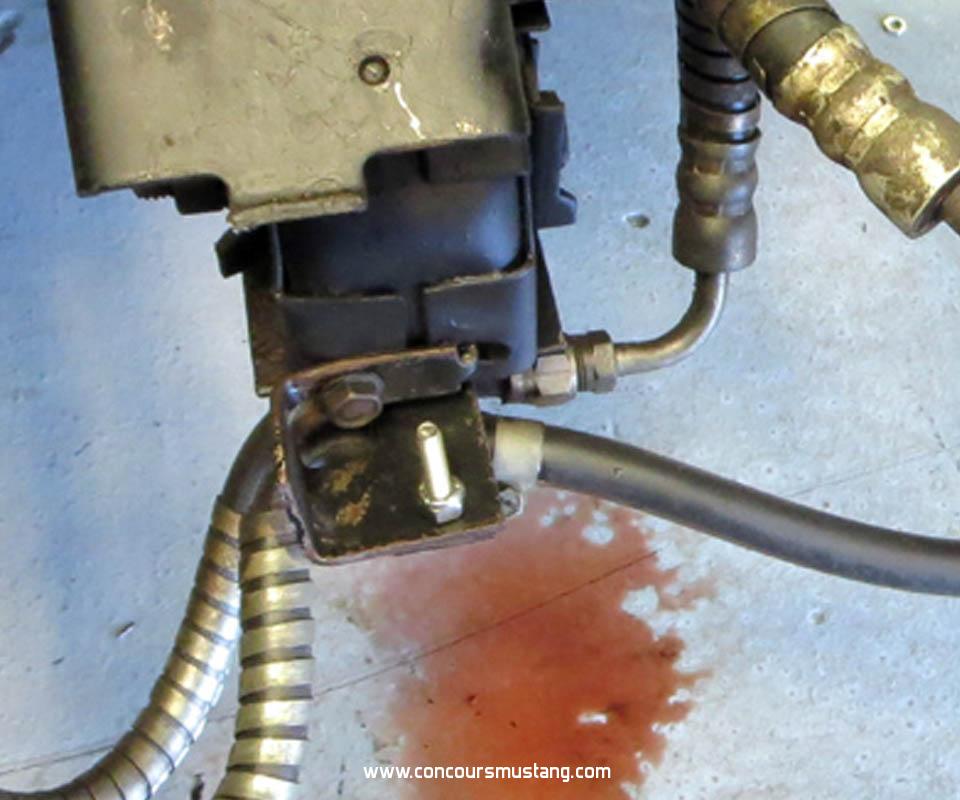

Looked through my pictures and found about a half dozen 48 Dearborn built examples of unrestored car with black motor mount and a natural bolt on L bracket as shown in the picture below. Attached to the right side of the motor mount in the picture.
Clearest picture of the bunch. Looks like a little dirt/grease or rattle can overspray along the top edge
Never seen gold cad or zinc dichromate on these pieces

Finally a reasonable finish is displayed. Bare steel should not have a "silver" finish as some restorer like to use. The raw material is darker than what is shown and probable comes in a fixed width roll to minimize waste or 10 to 20 foot bars with the same waste criteria. The manufacturing process involves a lot of oil to facilitate the bending process which will leave scratches from the dies. After welding (if required) the pieces are cleaned in a solvent, possibly tumbled to remove burrs and then lightly oiled to prevent rust. That's what you see here. I like to lightly phosphate bead blasted steel to get that finish.

Jeff, what's the small bracket that's welded/riveted to the bottom of the top side of the mount and has the small screw/nut thru it. ?
Never saw that before....

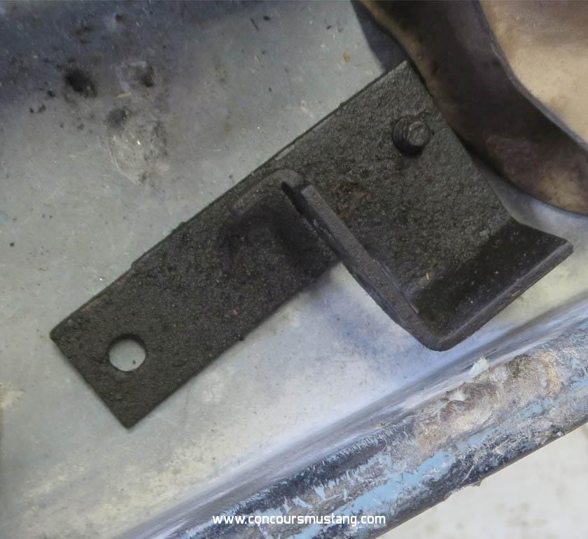

Because of the angle it looks like it might be attached to the mount but instead its attached to the lower a arm inner mounting point. It's the PS insulator bracket
Better angle for that item ;)
Note - Don't know if that shinny nut and bolt combination is original. Would guess no but sure Ed will know

The shiny nut looks to be the Teflon/locking sort.  That's shiny with one n.  I checked it the old fashioned way.  Brian

Both 69 and 70 Chassis Assembly manuals show both the power steering hoses sub-assembled to the main hose bracket with retainer, insulator and screw installed, the old easy of assembly scenario, and therefore do not document the screw. However, in the For Car Parts Illustrated Section 36.4 page 5, the screw is indicated as 40923-S, 5/16-18X1/2in hex thread cutter screw. As this screw is common to other power steering applications, 64-67, and shown with a -S8 clear zinc finish you can assume it is the same for 69-70. Occasionally Ford keep the same parts for multiple years. The -S8 finish "may" be -S2, phosphate and oil, as that finish is used as well on other 40923-S screws. I got the screw p/n, you can figure out what finish you want.

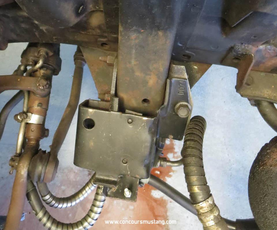

Looking at other 70 examples it appears that the bolt and nut are most likely a fix for a stripped out or lost original screw
No nut was used on the original installation
Looked through allot of pictures - best I could find - that at least shows size and length of that screw. From a 70 San Jose car if it makes any difference (don't think so in this case)

That's what I thought, but it looked attached to the mount....
The screw and nut are definitely a later fix, I have an NOS bracket assy with the screw if someone wants some pic's of the right screw, It's from an NOS power steering kit shipped to the dealer in mid 1969, and matches the original one on my 70 exactly...
