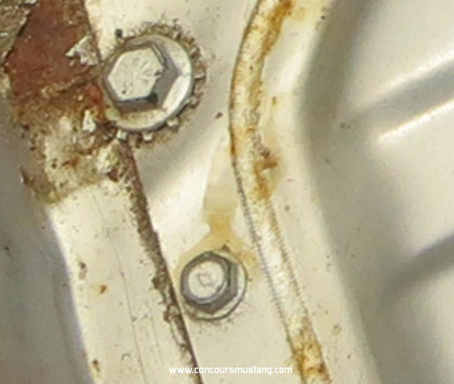

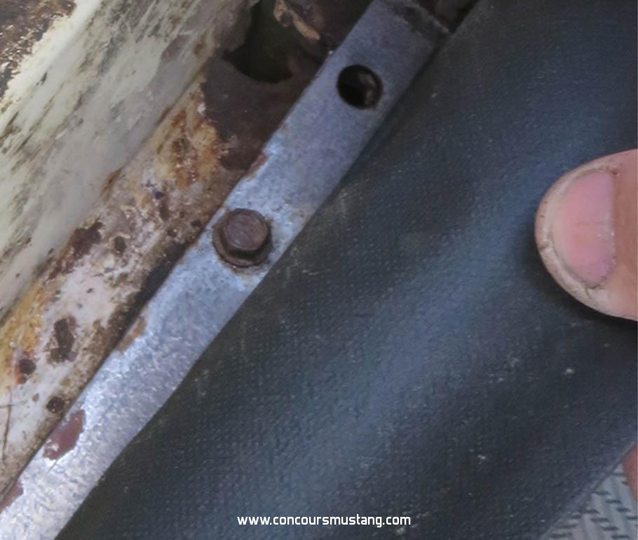

Guessing that your asking about fall 64 period at San Jose based on your other  threads.
Found the diamonds being used
Ignore finish - surface was rattle canned silver  by PO
Slightly later example = barely make the marks out due to the crud
