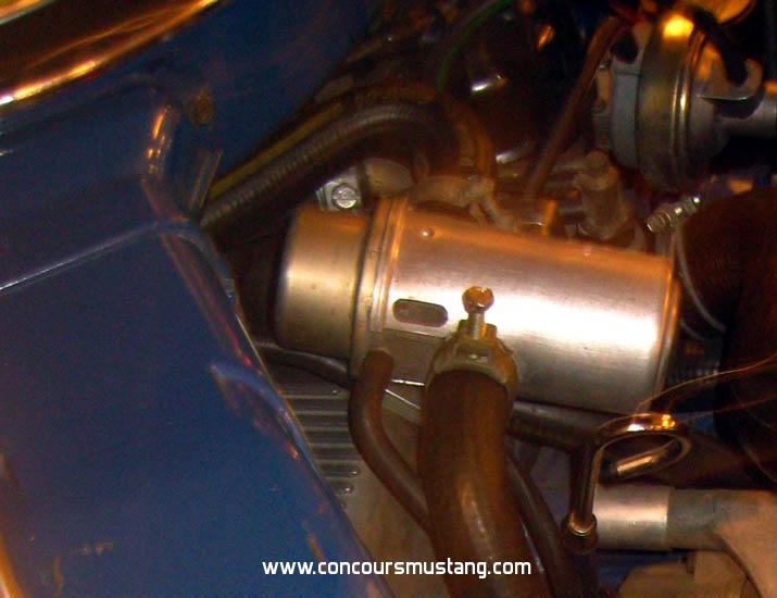

« Reply #4 on: April 14, 2015, 03:26:29 AM »
Just posted a picture over on the Boss 302 site - so figured it needed to be here also ;)
Unrestored - low mileage example 0F02G190xxx

Thank you for posting the picture jeff, is the band clamp on the outlet port of the diverter valve in the picture gold cad or silver cad .
Sorry taking so long getting back to this one
For the band (heater hose style) clamp believe originally the clamp was galvanized with the nut and bolt being silver cad. The Witteck (S?) was either gold cad or zinc dichromate. Have never tested either to know for sure but that should give you the look
