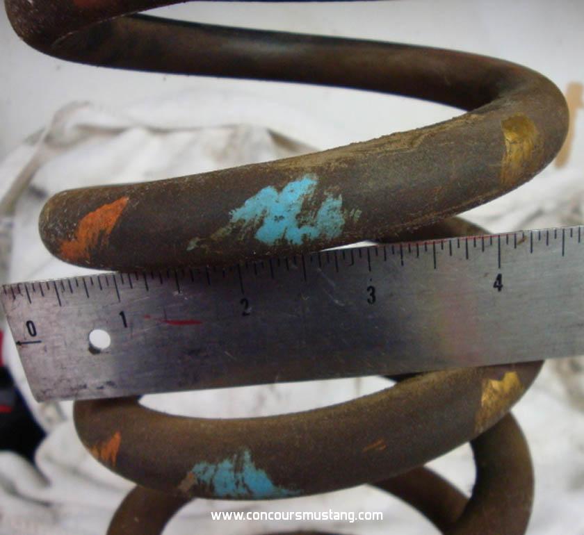

I am putting on new front springs on my 73 Mach 1.  Does anyone have information or pics of where it is applied to the springs?
Same basic method and process as other earlier years.
Identification mark(s) were applied with the brush in a way that any runs typically look to flow upward on the spring once its installed.
IMHO normally they look as if the paint was applied while passing the brush from the bottom to the top of the spring (towards the flat end) possibly sitting on the flat end or on its side. Of course out of the car.

Thanks Jeff.  That's exactly what I was looking for.

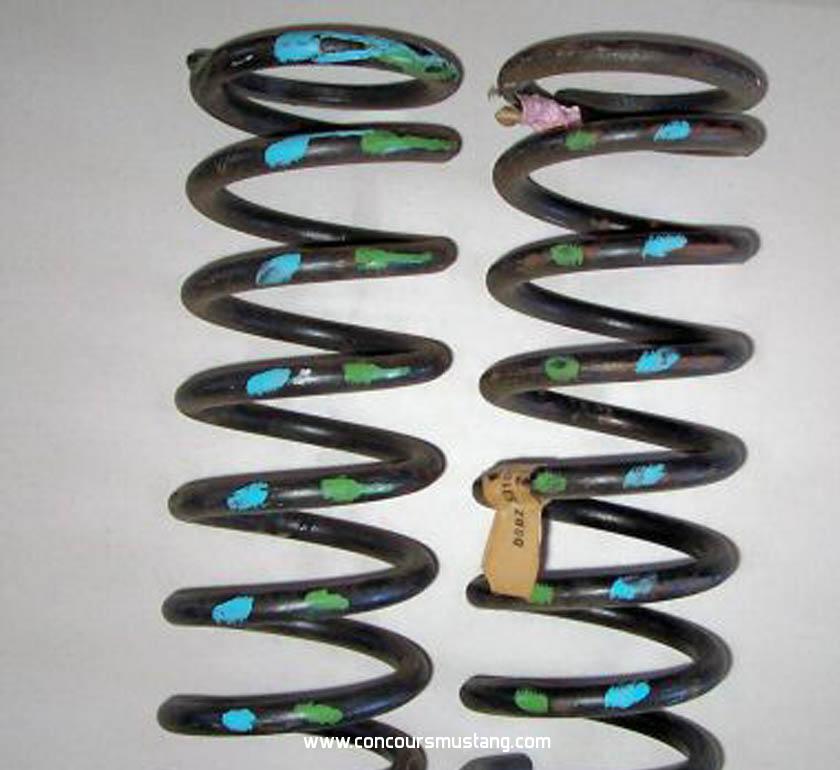

+1 to Jeffs comments.  Here are a couple more examples
67 GT S-Code, San Jose, 06/67
72 Mach 1, Dearborn, 01/72
