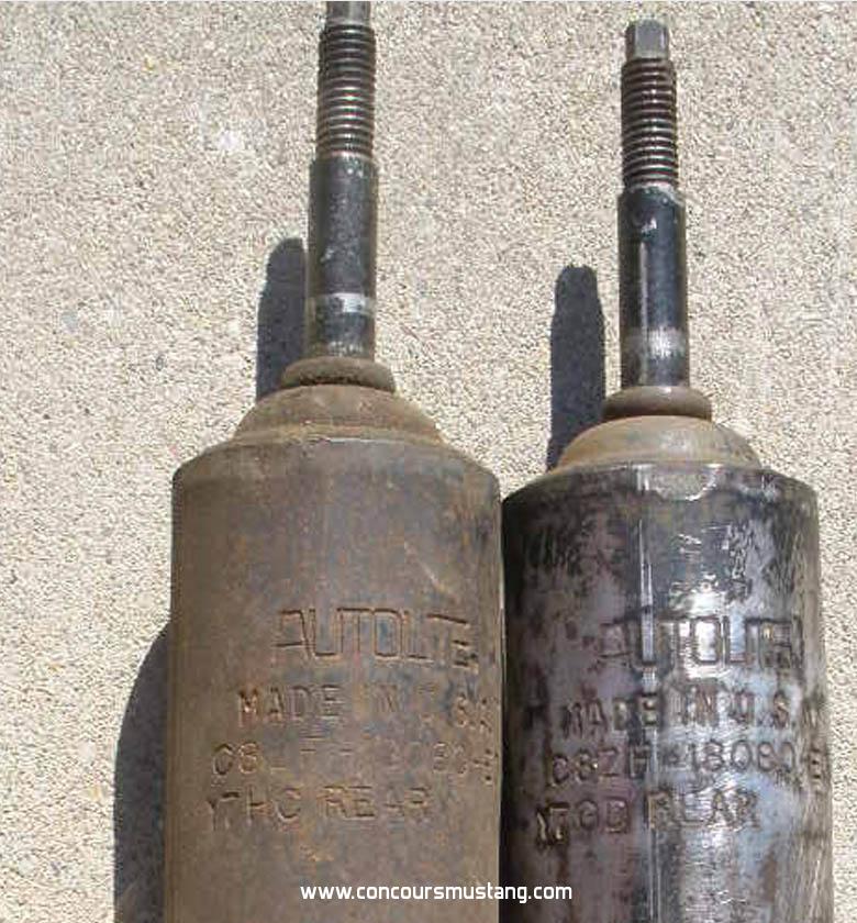

Yes they were Autolite - most likely stamped with  Made in USA stamped ones rather than Canadian ones because of where your car was assembled. That would make the the rears course threaded (made in the US) rather than fine (Made in Canada). Rears use the straight sided separate tubes - since you can see those much more than the fronts likely the ones to focus on initially
Be happy if you can find either style.

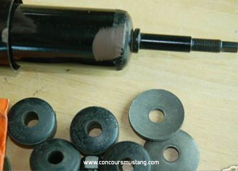

I'm often surprised what I find in my picture collection. On this subject I just happened to find a picture of the paint mark from a service replacement C7ZF-18080-C  shock that used the same color mark as I mentioned above. Don't know if this shock and part number carried over to late 68 but at least it provides a clue as to tine and tone of the brown used on possibly some of the original shocks used on your car. This happens to be a Made in Canada shock - the reason for the fine threads

The difference I believe is based on where the car was built and in turn where that plant got the majority/or all of their supply from. From looking at allot of cars it appears San Jose Mustangs got the Made in USA shocks and in turn course threaded rear shocks.  This came up years ago when a friend complained that MCA had approved some repo shocks (back in the old days when they did that sort of thing) and "they are all wrong"  it was reported. It basically came down to we were use to seeing shocks in the west marked Made in USA and with course threads and the person reproducing the shocks choose a shock that was typical shock that was seen on cars in the eastern US.
Some home work was done and that was the conclusion that seemed to give logic to what had happened and the difference of opinion.
