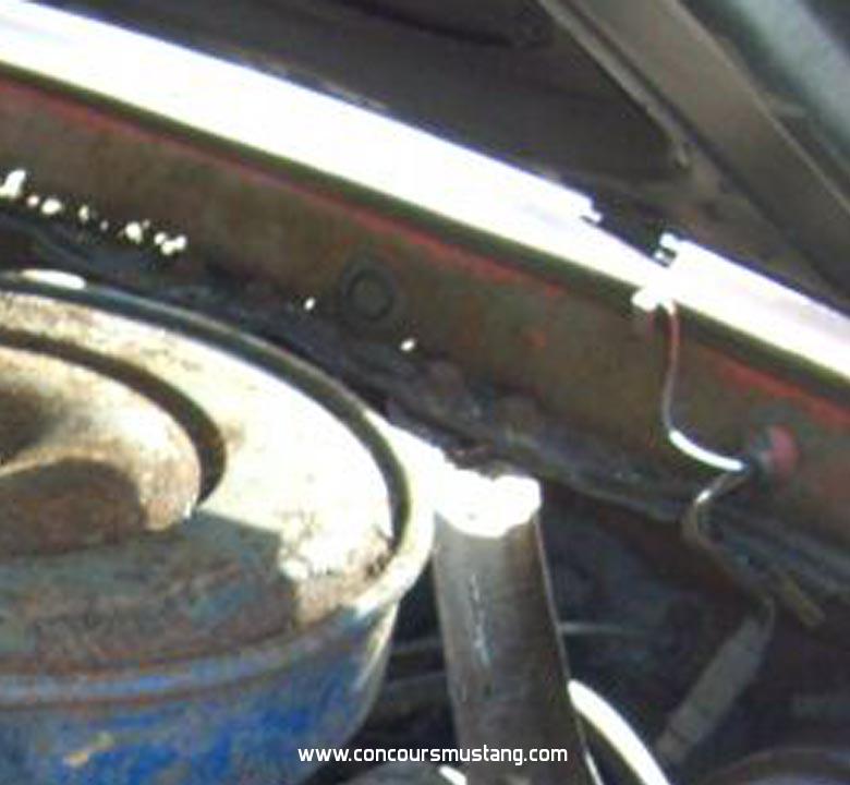

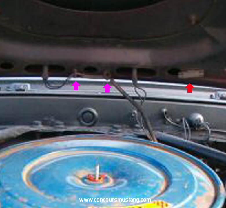

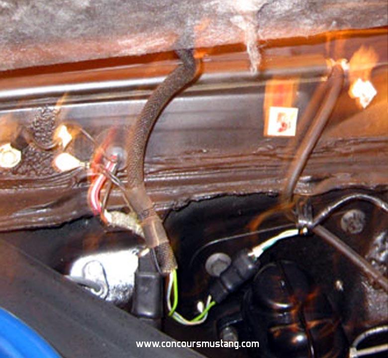

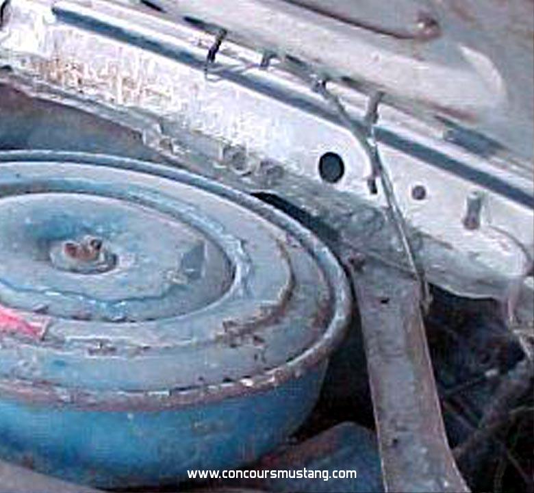

The problem is the clarity or lack there of in the pictures I have. Looking at all three plants I found some with the eyelet attachment (black t sort of thing) with the mounting screw towards the front of the hood (eyelet bracket behind) which makes it easier to make out. While others its hard to say - you can make out the section of the clip opaque or black with the small holes and slots at each edge but if the eyelet is to the rear end of the hood its hard with what I've got to tell what kind of bracket that is
The first picture (above) is from a very early car and that one is clearly the opaque style with the push post. If date makes a difference in what they were using. Additional pictures of 69 Dearborn cars follow. Allot of my examples (not posted) have aftermarket loops and retainers added over the year or the wires are simply hanging.
9F02M178xxx
9F02M193xxx
9F02M216xxx
Just what I've got at the time
