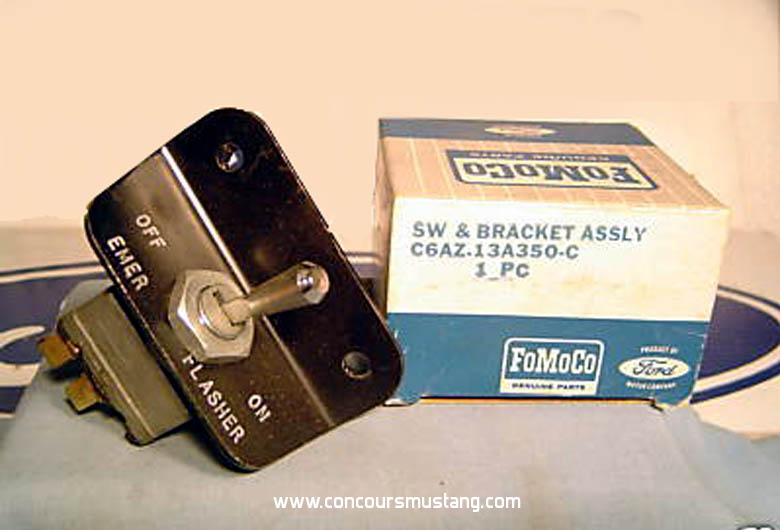

Ok, so the clamp shares the same rectangular plate used to sandwich the glove box between the toggle switch?
Bought May '81, sold Sept '20
  • Posts: 24873
Re: 66 Emergency flasher relay mounting?
« Reply #5 on: July 02, 2015, 02:34:05 AM »
The L bracket the switch is connected to is held in place with those two machine screws - they thread into a thin plate on the top of the glove box liner
