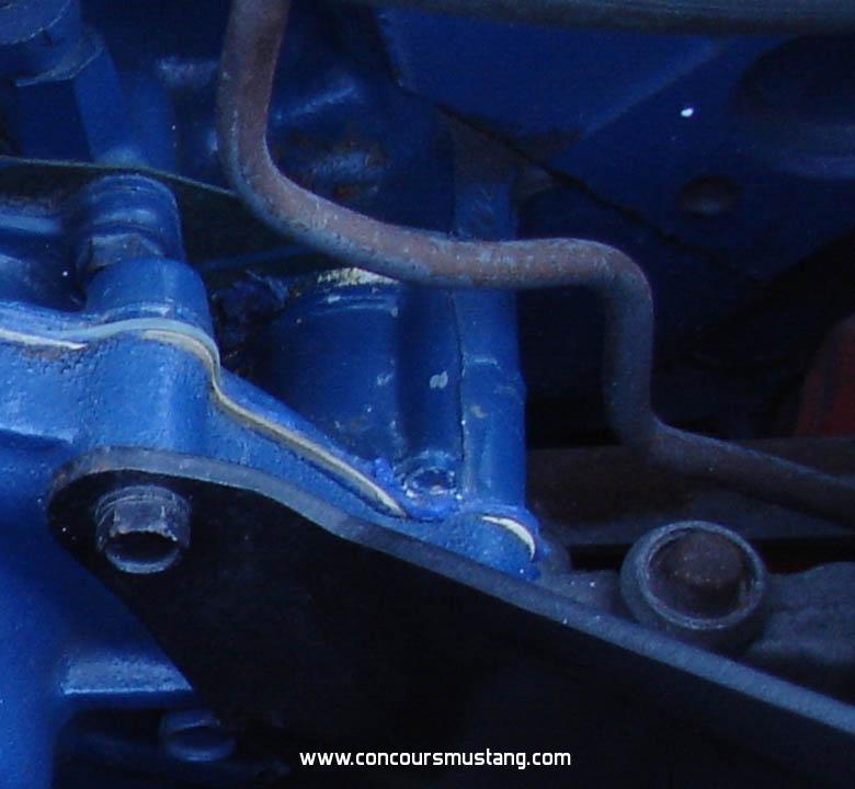

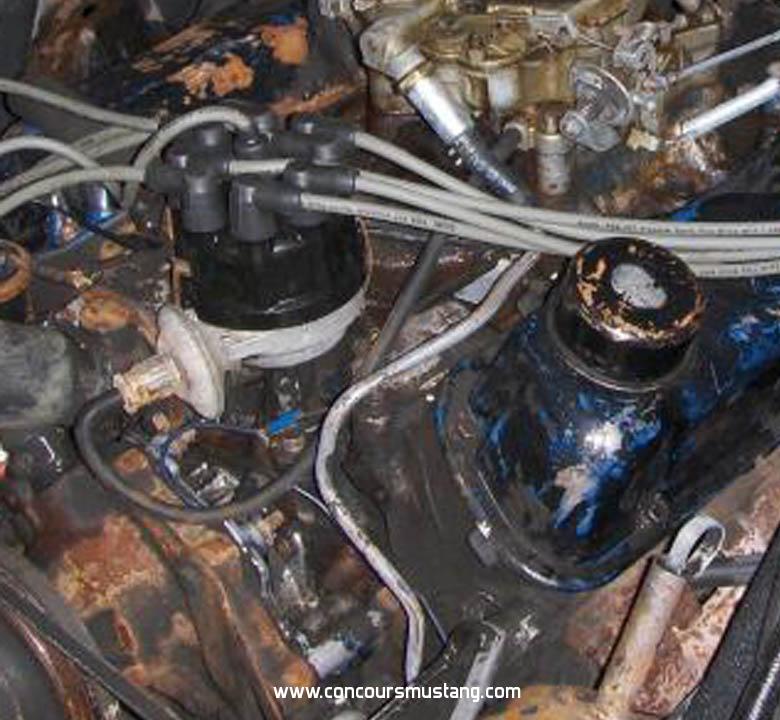

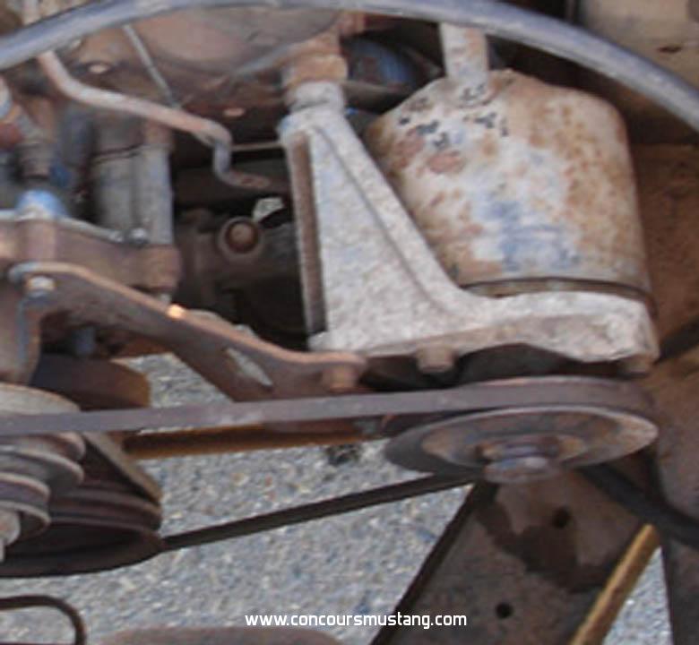

I've looked at countless pictures  trying to find a '67 289 A code with a 4300 carb to see the routing of the fuel line(opposite side of the distributor as for a 4100) and haven't found a single one.
  • Posts: 24867
Re: '67 "A" code Autolite carb
« Reply #20 on: June 13, 2015, 07:59:05 PM »
Pictures can be a challenge - normally air cleaners, AC pumps, brackets and such in the way. Also always seem to be one or two owner added twists and bends that have been added for one reason or another
Not the best but something
And yes the top section runs down the drivers side for the 4300 rather than the 2100 side (passenger)
