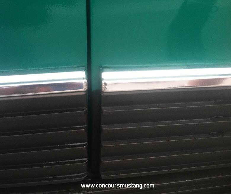

Quarter panel to rocker and door

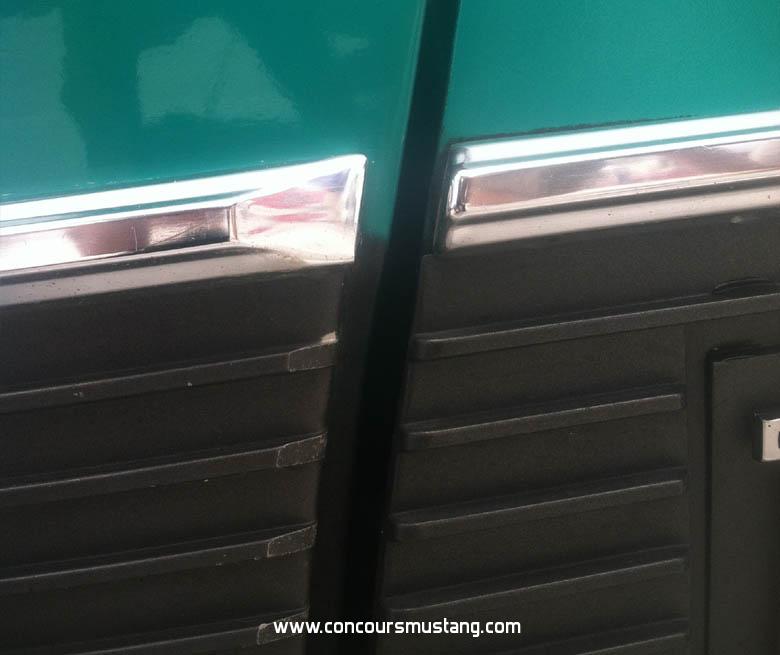

Passenger side fender to door gap

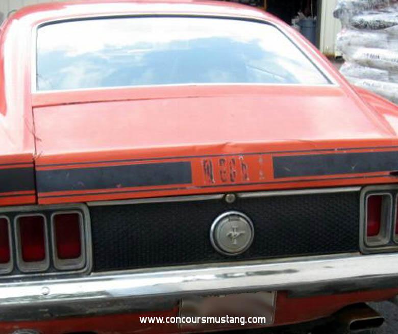

Taillight panel - in the one example it appears the black has been polished or worn off where is was accessible

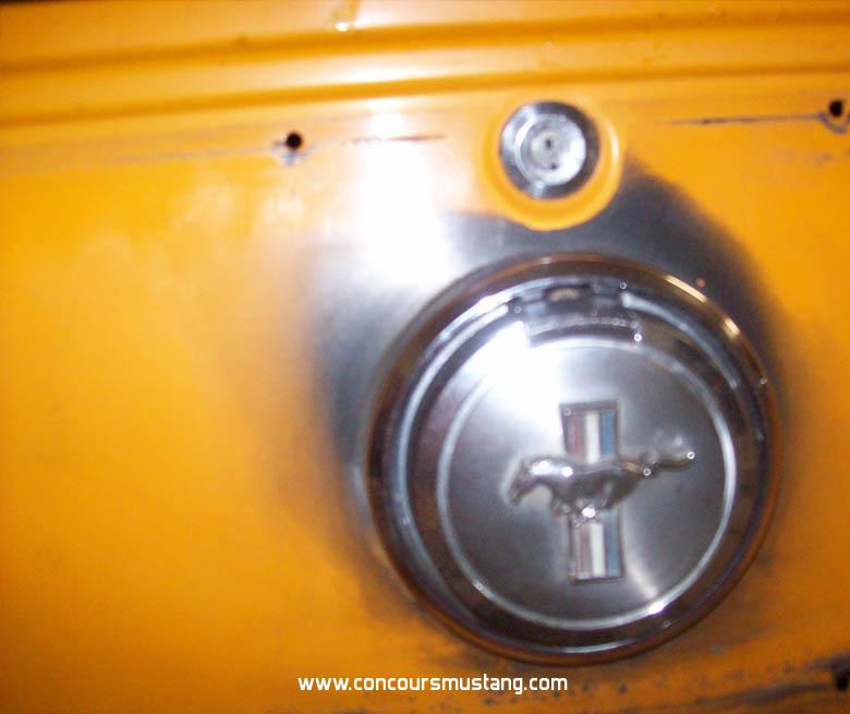

Hard to see but it appears that the area around the trunk lock is black out when comparing contrast and color

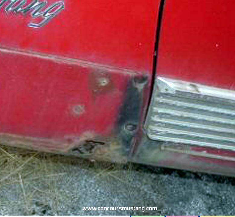

Example where it appears the shop of owner had started removing the black-out
