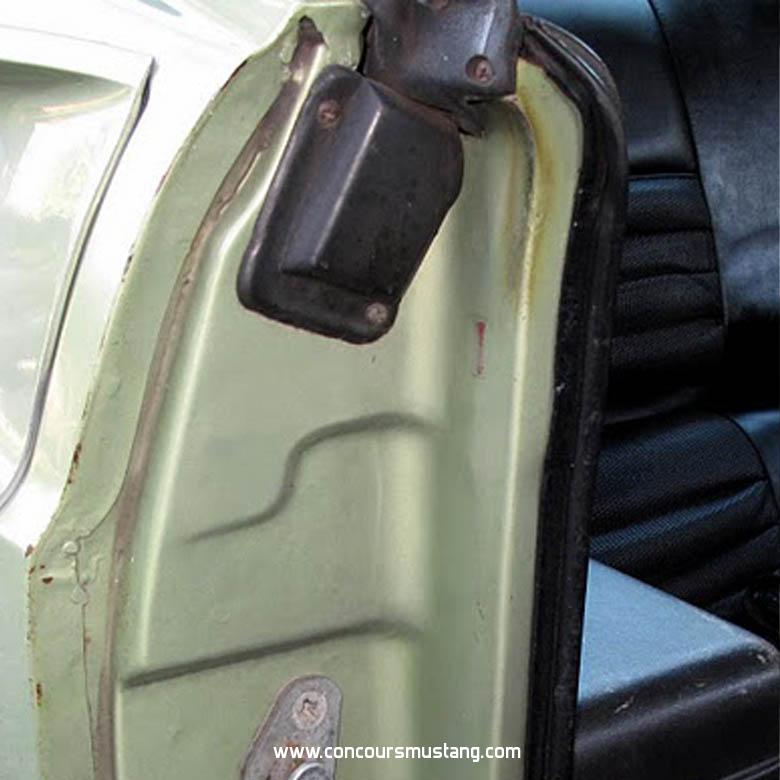

Can someone please take a look at the attached picture and tell me what these two holes are for? Is something supposed to actually be bolted into these? Is there a cover of some sort that covers it? What is the function? Thanks in advance.

Well not real sure what I am looking at so...  This is a picture of a 69 Left Side rear door/jamb frame for comparison.  Brian

For the window stop on a coupe or convertible, there is a cover plate painted body color with two holes drilled in it that covers the oblong holes.

Looks like you have a B pillar from a coupe or convertible and those two holes - hold part of the window mechanism in place (to the body)
Those two holes would have two zinc/cad bolts holding an adjustment plate much like you will find on the top inner surface of the door - all body types
Notice also that the slot at the top (in this case for the window not the little quarter window pivot in Brian Conway's example.
Someone much have used a donor car (different body type) if this is on your Mach I as shown in your signature

« Reply #6 on: September 02, 2015, 04:39:58 PM »
Looks like you've got some more work ahead :(
Too illustrate
69 Coupe
69 Sportroof
