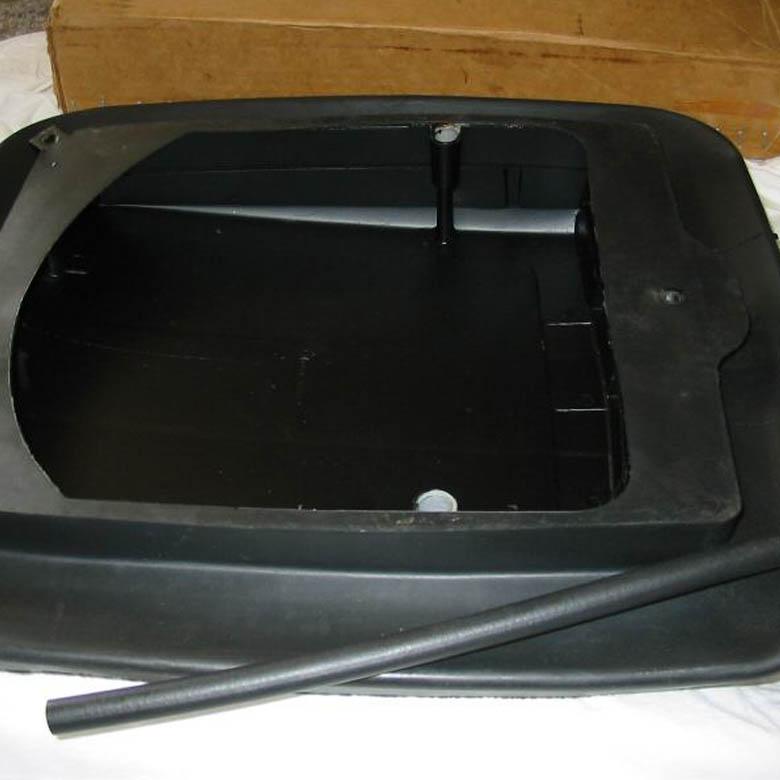

Is this 69 Mustang Shaker an original or a reproduction? Looks like fiberglass in the bottom view.
I think NO, it's an older Repro
Offline rayms69
  • Posts: 236
Re: Shaker? Is this Real or a reproduction?
« Reply #1 on: December 19, 2015, 04:28:54 PM »
I don't believe any real shakers were fiberglass, that is fiberglass right
10-26-1969 Dearborn 428 SCJ auto
Offline Brian Conway
  • Posts: 1623
« Reply #2 on: December 19, 2015, 04:35:06 PM »
The OE metal ram air scoop has a C9 number cast into the down side.  Brian
5RO9A GT  4 Spd Built 5/29/65
9TO2R SCJ 4 Spd Built 9/19/68
Owner Driver Mechanic
San Diego, Ca.
  • Posts: 5101
« Reply #3 on: December 19, 2015, 05:30:00 PM »
That's my thoughts too. Thanks
Offline preaction
  • Posts: 1330
« Reply #4 on: December 19, 2015, 06:07:34 PM »
Is this the part that Tracy had for sale here ?
  • Posts: 5101
« Reply #5 on: December 19, 2015, 06:15:25 PM »
yes
« Reply #6 on: December 19, 2015, 07:29:55 PM »

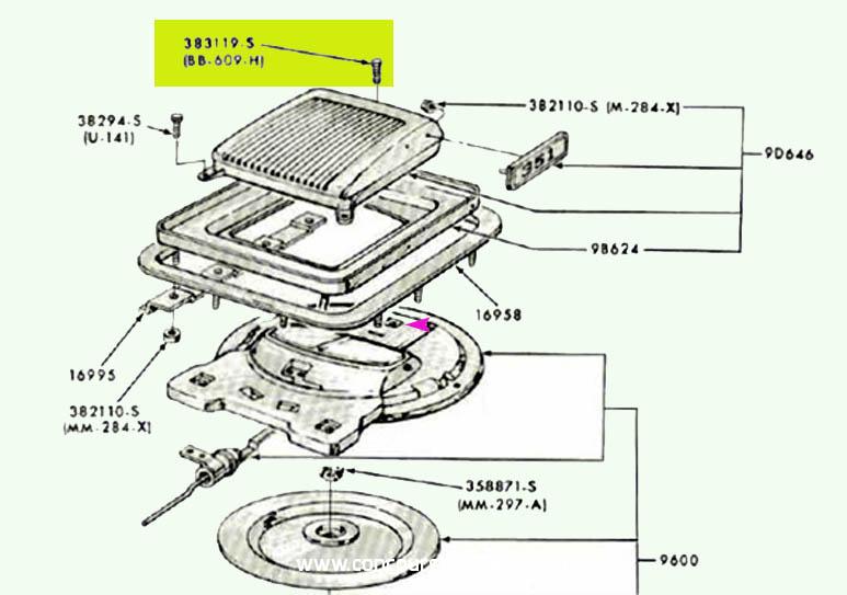

Mounting "tabs" of the scoop section is one of the hints that its not original
Mid plate is from a different application
Exploded view
