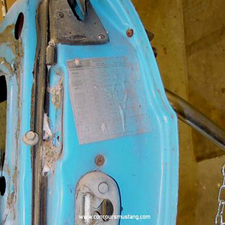

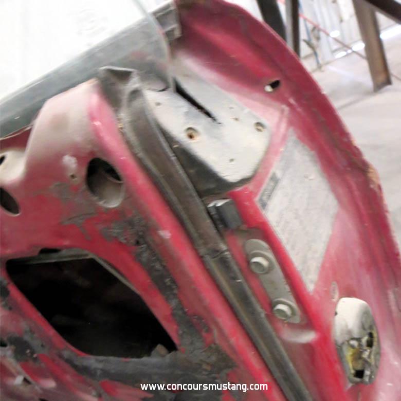

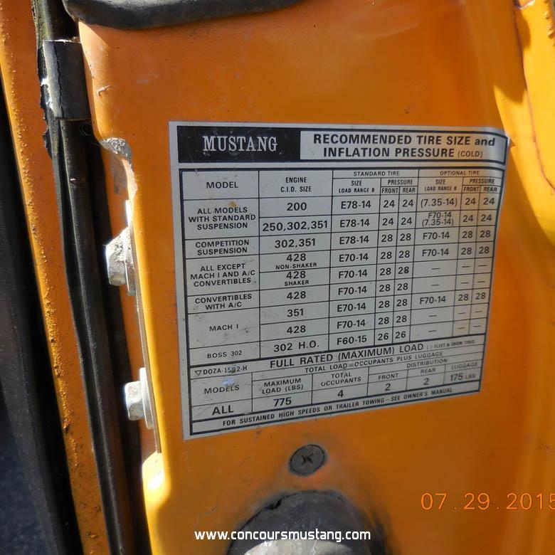

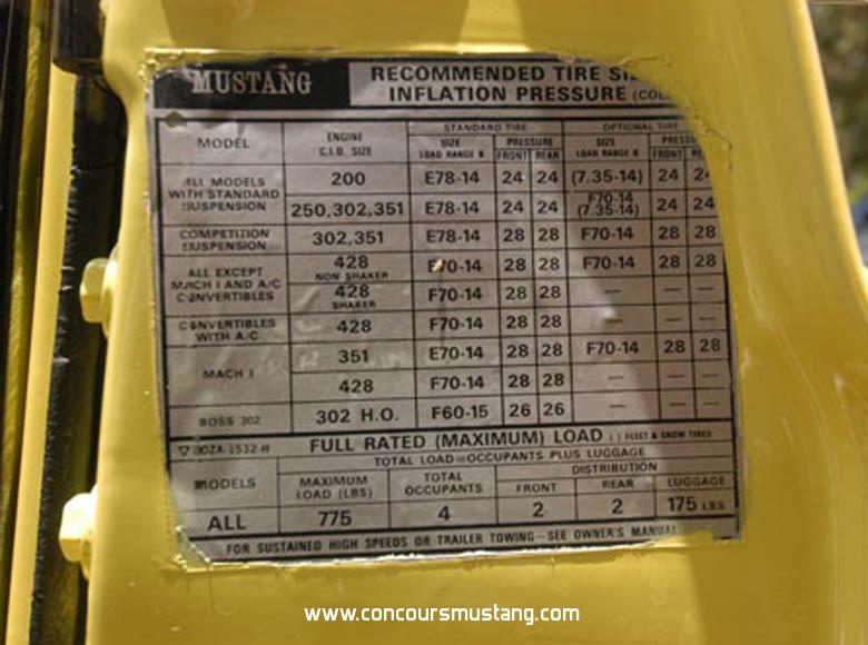

For this thread we're looking at 1970 version of the same decal to see if there were changes during the year so restorers can use the correct one for their car and its build date. Subject should help with location and version
Dearborn examples
0F1176
0F1427xx D0ZA-H decal version
0F158xxx D0ZA-H decal version
0F1676xx D0ZA-H decal version
