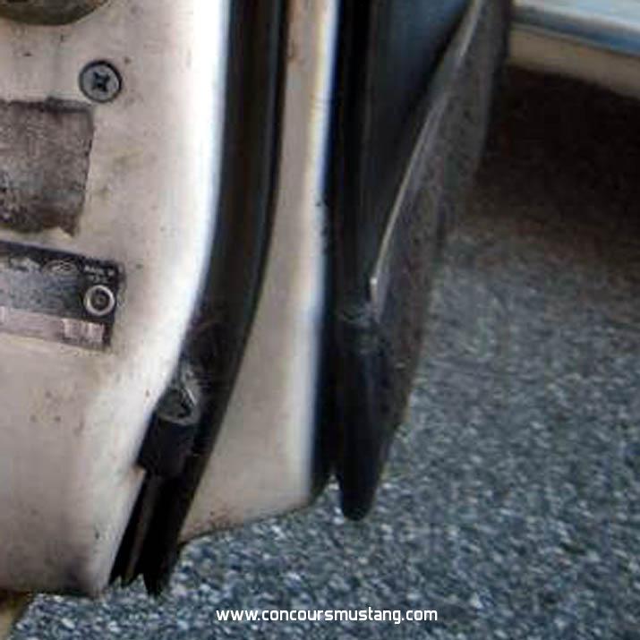

Couple of easy to find examples showing nothing but body color from that plant and that general time period

69 with standard interior used shorter door panels which required the exposed metal to be painted interior color. The Mach1 pictured used the deluxe door panels which covers the flat areas thus not requiring interior paint.

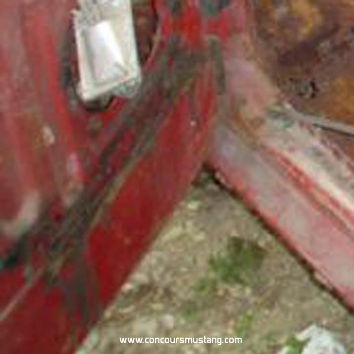

I thought I'd share a pic off my old SCJ Mach Auto drag car.   The car had a repaint in a Lacquer real candy apple red paint job in 1973.  The car was raced and pretty much other wise all original.  Notice they poorly taped off the door jam.  Notice the lower door.  They did black this one out.  SJ built jan 69.   Now over the years I have thought about this and I was thinking maybe they did it at first as it came down the line because they thought it was standard interior non Mach?   Just an Idea.  Either way it is unusual and of course you can never say never.

Thanks for sharing - the car at least appears to have been repainted or at least jammed at some point (door latch screws are painted)
Have seen one other example where the painter/masker didn't match the detail to the application this your example. This is why its important (when possible) to document the car before you start stripping so that these unusual - non typical details can be preserved/document and reproduced if the owner chooses to. Think the other example was a Dearborn 69
Thanks again

Yes the jams were painted, but not cleared and polished like the outside.  The car was originally Indian Fire red.   When you look at the terrible paint job they did, it is amazing they did tape off the black. If you can see it in the picture, there is over spray on the lower half of the door panel.

.............. If you can see it in the picture, there is over spray on the lower half of the door panel.
Wow - thought that was a reflection  in the vinyl  ::)
