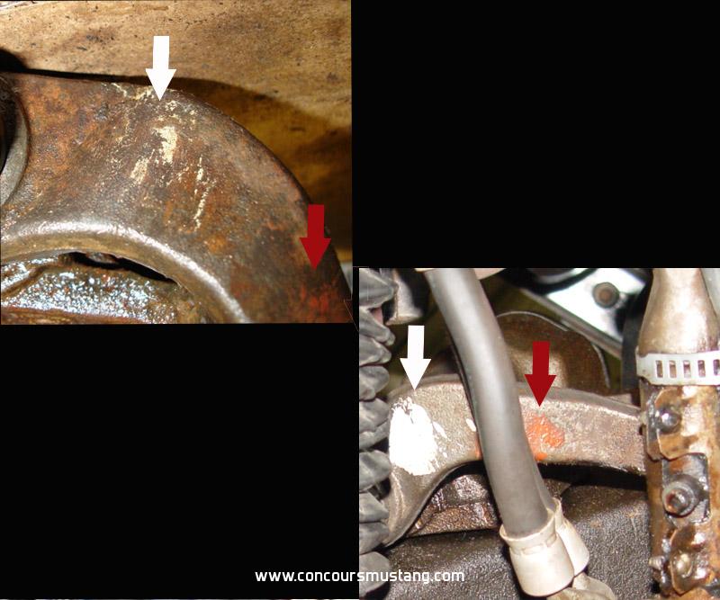

I've found different paint markings on some parts between originals and service parts this may explain some of the conflicting findings you mention
Example would be "1965/66 eight cylinder Mustang C5ZZ-3590-A".
Have originals (65 in this case that I'm looking at) marked with a white and muddy red/red oxide. While have pictures of service parts marked muddy red/red oxide and light blue
Paint markings may only apply to certain production periods since things can change and processes refined

Jeff - yes for the C5ZZ-3590-A I have photos of blue paint markings and others have told me white so until I have better will just leave that blank for now.

None with two marking as I mentioned?  Sounds like you have pictures with partcial markings

Exactly what I was referring. Under the lower edge and part number it appears you can make out the white paint under the sticker. As mentioned this does not match what has been found on original 65's. Will share a couple of those in a while kind of late  :)

Here are two May 65 Dearborn examples for the power steering pittman arm marked as described above. A dark muddy red and a white on each. Hope this helps

Thanks Jeff....good data points indeed.  Good reference photos - hard to argue with those.
