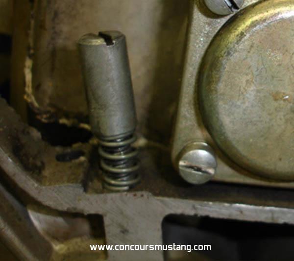

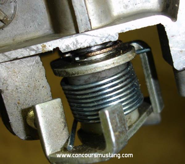

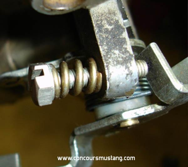

 Looking for a picture or info of the spring colors on the 4100 4v carb on 65FB Dearborn Mustang ? Thanks John

Have pictures of what was reported as an early 66 take off will try and help from that example rather than going the service replacement route.
Forgive me for not looking up the official terms for each spring ;)
Short heavy throttle/idle spring - zinc dichromate
Throttle shaft return - Look to be bright zinc
Idle adjustment - Look to be bare steel
