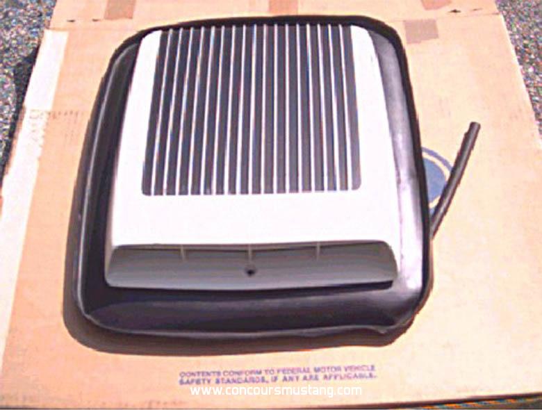

« Reply #3 on: December 15, 2015, 05:59:07 PM »
Checked my pictures and the only examples on a car, are restored cars :(
These pictures were represented as NOS examples - take that for what its worth. Don't recall shaker scoops NOS in the box having a seal installed.
Now that I've given it some thought there was a display at Perkin's shop at one point (could still be there) that had what was likely a white shaker that looked like the one in the pictures
IMHO if I were looking at other sites for research I would suggest the 428CJ site over Vintage.
OF course "facts" get mentioned one place - seen - then repeated over and over so got to be careful ;)

Re: 70 White shaker finish question
« Reply #8 on: January 28, 2016, 05:15:15 PM »
I will probably paint it like the one pictured above. Is the black between the fins the same low-gloss textured black that was used for the black stripes? I would think so but want to be sure.
« Reply #9 on: January 28, 2016, 07:00:40 PM »
Don't think it was a textured paint - more like the 69 blacks in finish look. Think trim ring since it was painted by the provider rather than stripe painted at the factory
