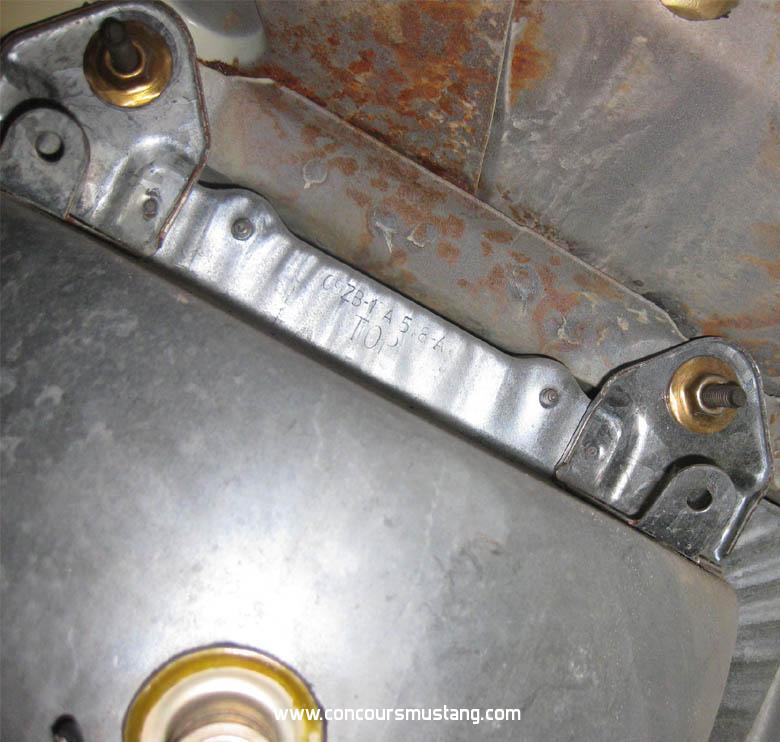

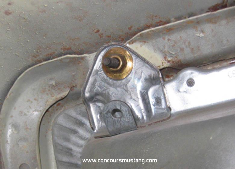

I've found quite a few also have what appears to be galvanized attaching brackets over the cad plated housing and they were spot welded on. Hard to reproduce, for the garage restorers and even some shops without the right gear.
Sean have you tested the finish to confirm what you've listed?   Was just looking at test kits and chemicals last night to do this
For the attached mounts - agree have seem some that appear to have a finish that may be galvanized. Hard to tell IMHO on such a small area, especially with mounting nut marks on the main surface. Since its the same product as zinc plating easy tests will not show a difference in thickness
Couple more close-ups. Looks like the faux galvanized trick would likely work for this purpose
For others reading this
As mentioned in other treads, in most areas of the developed world Cad can be impossible to get done in country (been outlawed for years) or its really expensive compared to zinc which can be almost identical depending on allot of conditions

Offline Bosskraft
  • Posts: 19
Re: Original Finish on '69 Taillight Housings?
« Reply #7 on: January 17, 2016, 02:26:54 AM »
G'day Jeff, no, haven't done a chem test. It's purely observation based.

Offline Anghelrestorations
    • Anghel Restorations
« Reply #8 on: January 19, 2016, 12:39:03 AM »
I've seen the same thing here - the attaching brackets with a galvanized look to them.  Have several examples of this in the shop.
