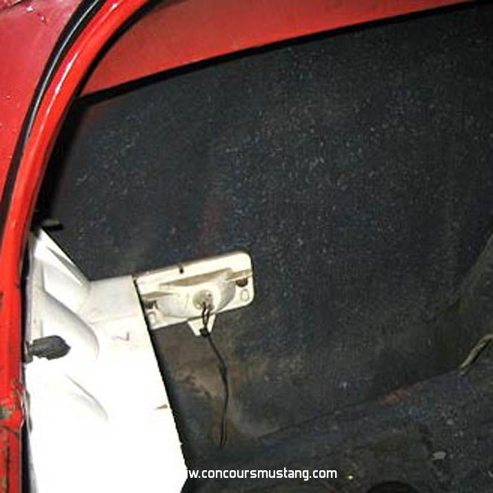

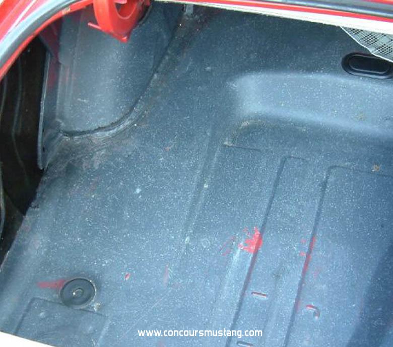

Ok so we don't need to find examples for the floor/undercarriage - still not sure why they did the floor sound deadener on a standard interior but there it is

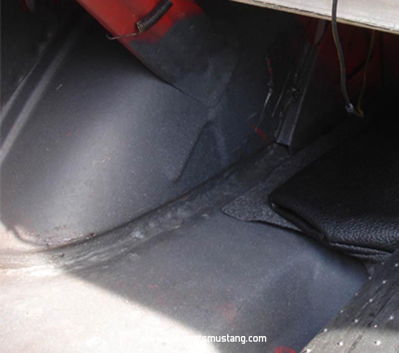

All the pictures appear that you have the typical sound deadener applied (before exterior color) applied to the inside of the quarter panels - staying back from all four edges by at least a few inches and in most cases away from the marker light so that it would sit flush with the surface ones installed.
Seam sealers as usual, applied before the body color also
At some point before any parts were installed (except for the metal floor plugs) it appears that the openings in the trunk (taillight holes, bumper bolt and marker light holes were masked off from the outside the trunk and the zonatone finish was applied.
Trunk pictures
Rear Wheel Wells

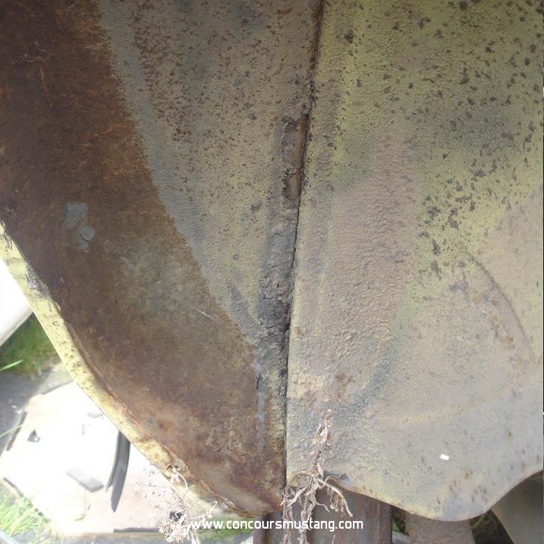

Like other years rear wheel well sound deadener was applied before body color was applied - likely at the same station adn time as the trunk surfaces were done. Unlike earlier years it appears that at least some workers were playing it safe and stayed well away from the outer lip of the wheel well lip as shown on the cars in the following pictures
Will find  and post some front wheel well. Of course this sound deadener would have been applied (like other years) after the car was completely assembled but likely with the front wheels and tires off or at least that will make it allot easier for you applying the product today

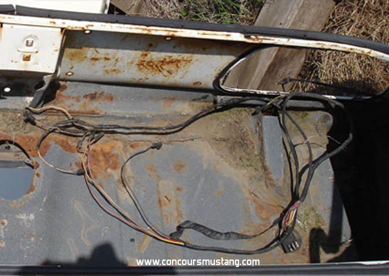

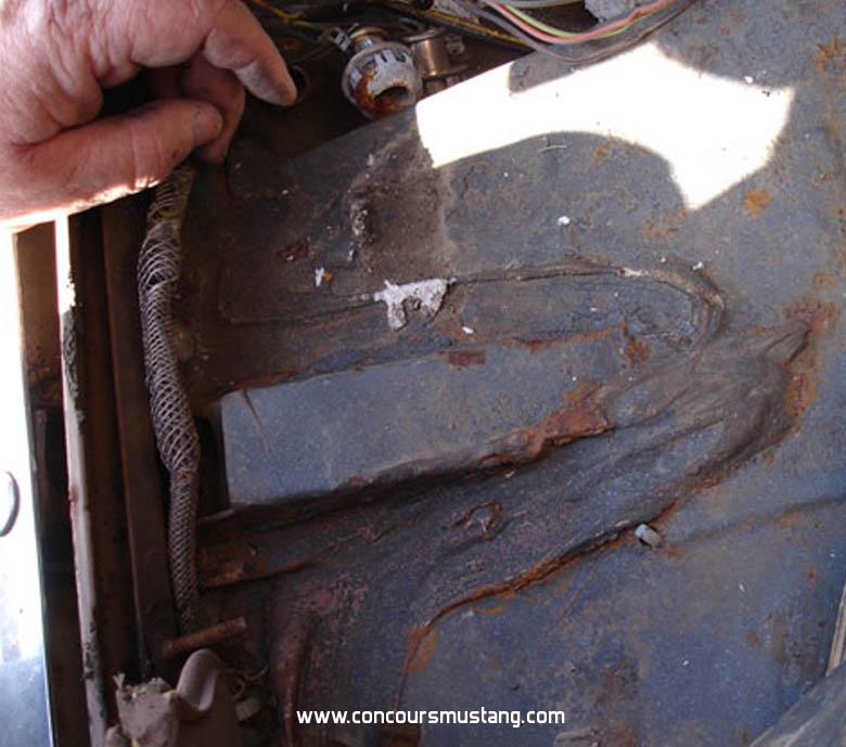

All great comments from Jeff.  I would like to add that my research indicates that the rubber round plugs in the trunk floor would have been installed prior to zolotone being applied.  I think your pictures do a very good job accounting for your car.  Also per the judging rules for 71-73 you should have some zolotone splatter on the trunk floor seal for the gas inlet pipe.  Here are some pictures for my 72 zolotone application in a fastback mind you.
67 GT S-Code, San Jose, 06/67
72 Mach 1, Dearborn, 01/72
Re: 1971 429cj convertible under body sound deadener/paint application???
« Reply #7 on: February 03, 2016, 05:38:15 PM »
All great comments from Jeff.  I would like to add that my research indicates that the rubber round plugs in the trunk floor would have been installed prior to zolotone being applied.  I think your pictures do a very good job accounting for your car.  ............

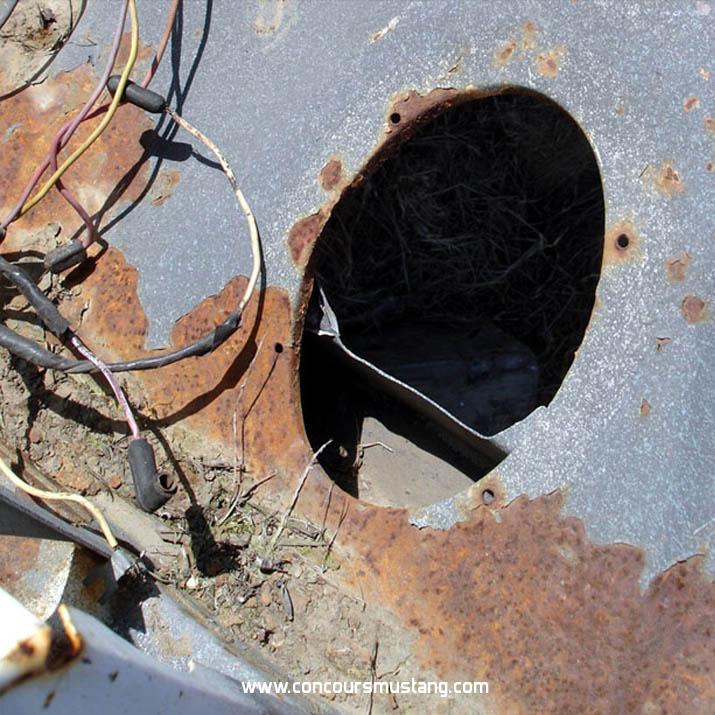

I'm been finding original examples of 71's suggesting that they were installed after the multi color and on 72-3's before. Similar to the marker lights and filler hoses.
Notice no shadow from the filler neck being in place when the Zonatone was applied
Looks IMHO like there was a change (likely from 1971 to the 1972 production) at some point with the order of things done.

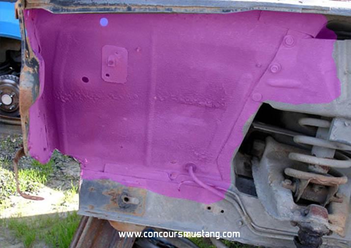

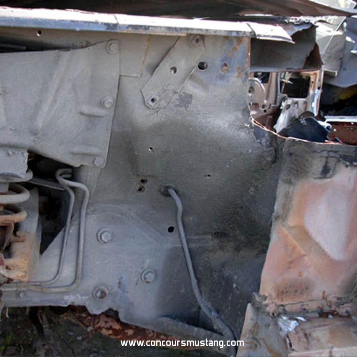

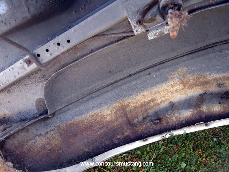

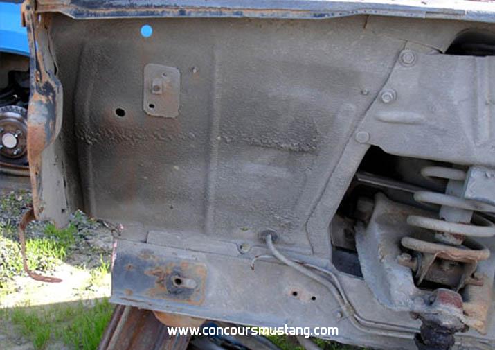

Front Wheel Wells
Sorry I don't have a ton of pictures - in fact very few. But here is what I can offer
The sound deadener pattern and application can vary allot. By 71 they appears to normally be a fairly heavy and wide applications when compared to some other years and plants. Remember that in the following pictures this is only the inner fender panels so the sound deadener application would often (but not always) include the front and rear splash shields and the bottom of the fender.
I attempted to high light the area where it appears the deadener pattern is as I have done in the past in other threads
