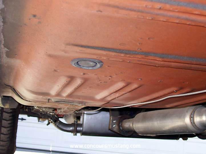

Sounds like a bit of confusion and mixing of different plants and years in the conversation
Fist I guess your car is too far gone to offer up what was originally applied to your car - the reason for the question
Without option gone we have to rely on other cars built the same plant around the same time - in your case March 68
So VINs in the 176xxx-191xxx range one would guess
So looking at my collection I found what I was expecting - red oxide from firewall forward and red oxide from firewall rearward like on the other years at NJ
Here are a couple of pictures from examples One durign the period and one right after that period

Not that its the "favorite" - just what they used.
You'll also have body color and pinch weld over spray as well as the black sealant around and along certain areas

The procedure the chap was describing is what they did at the Dearborn plant line and not the Metuchen line typically. The floors are most typically  as Jeff described.

I have seen hundreds of 68 NJ cars and all were red oxide. The color is actually a little browner, but definetly not batch paint or black.
