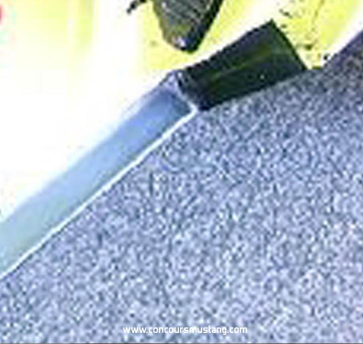

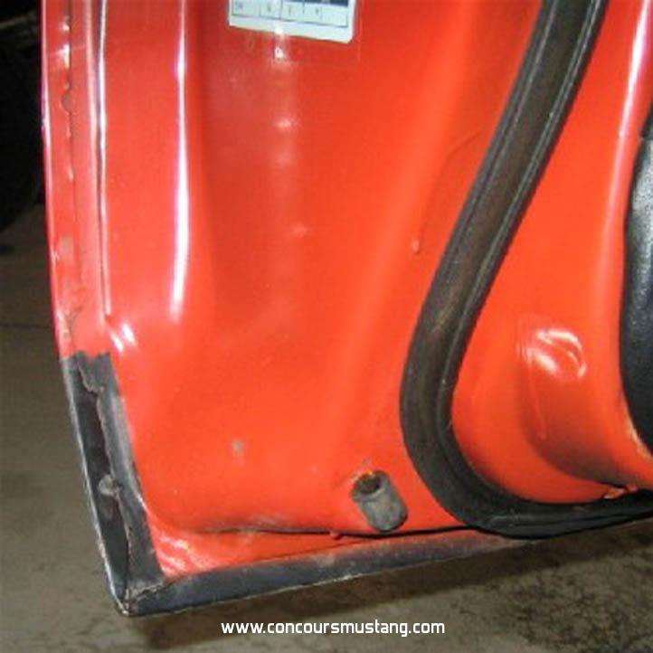

Anyone have some pictures showing where silver paint was applied to door jamb and rocker panel areas. Also lower door wrap around and bottom of door.  Thanks to all who replied to silver paint code question!

Here are some pictures showing the finished edge at the door way. Just substitute the black areas with your silver.
The silver and black was applied first, before body color and masked off so the pinch welds are not normally blacked out and the overspray found under the car is general from the silver or black rather than body colors like on those cars without this option
