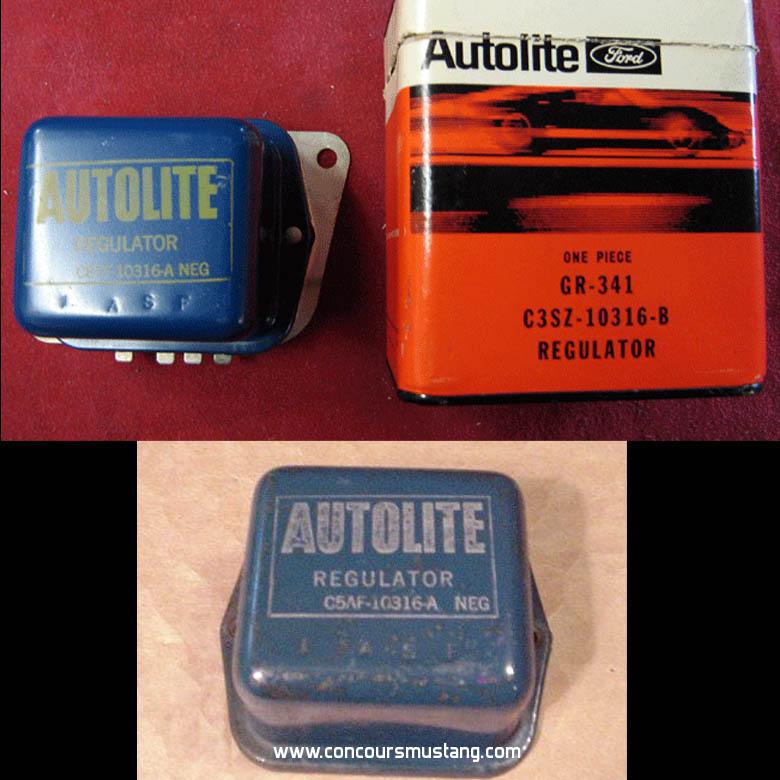

67 s code gta April San Jose  no a/c what  would be the proper  voltage  regulator  for this application ?
Typically C5AF silver stamp.

My investigation says, gold stamped when it is with A/C.
But could be a difference in built plant and built date as well.
Mine is San Jose 11/30/66 with AC.
I might have a NIB repro voltage regulator, Silver stamping, older design without the larger cut-out many repro's today have.
Never seen a gold FoMoCo or Autolite stamped regulator any plant or year.
Might you be seeing yellow?
Have seen some Motorcraft that were sort of orange/goldish
Ralf
C5TF is yellow stamp which is what you are probably referring to. It has a different capacity then C5AF silver stamp . C5TF is Typically paired with 55amp alt and also common service replacement .

WCCC:
Mustang 1967
Voltage Regulator w- Air Conditioning - Repro
http://www2.cougarpartscatalog.com/c5tf-10316-a.html
Voltage Regulator COVER Only w- Air Conditioning - Repro
http://www2.cougarpartscatalog.com/c5tf-cover.html
May be WCCC is wrong here?
