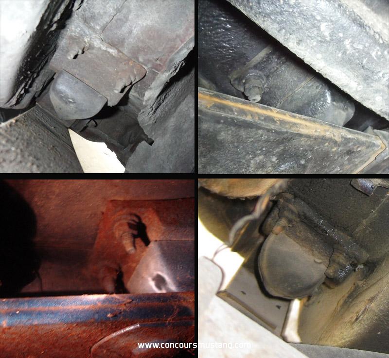

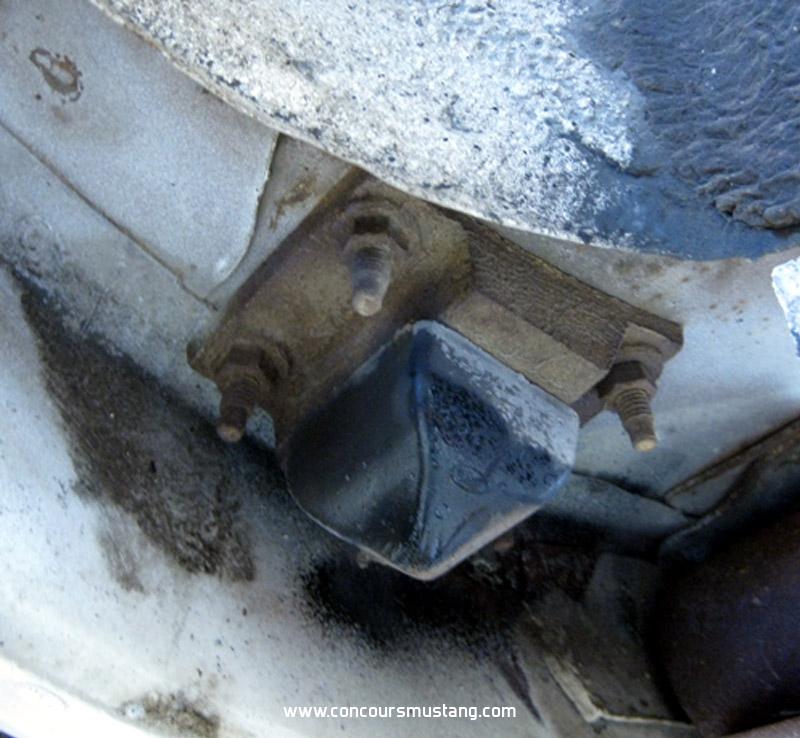

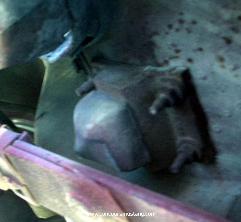

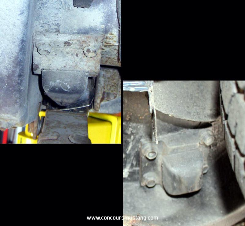

Here are some unrestored examples. Sorry once I was in the pictures just grabbed a handful from across the production year
From a sub #100 examples
#500 - #1000 examples
#1000 - #2000 examples
From late in the year Approx #283xs - Multiple cars shown

By far the most common in the later 67 Shelby's is the tapered end bolt and a hardware store generic silver lock washer and silver nut .

« Reply #3 on: February 23, 2021, 11:41:57 PM »
Again, the Shelby changes reign supreme!
The sub 100 cars look like the Assy Manual.
The 500-1000 cars seem to have a slightly shorter bolt length than the
1000-2000 cars, like mine. My bolts are long too.
The last set I can't tell for sure but I can't see a lock washer.
Great pics Jeff!
Thanks for the info, Bob. I have the taper end bolt with tooth washer.
This thread is but one of many reasons why this forum is so great!

« Reply #4 on: February 24, 2021, 05:34:47 PM »
No visible washer found on many of those examples

« Reply #5 on: February 24, 2021, 08:54:46 PM »
I double checked my notes and pictures to confirm that yes no lock washer .
